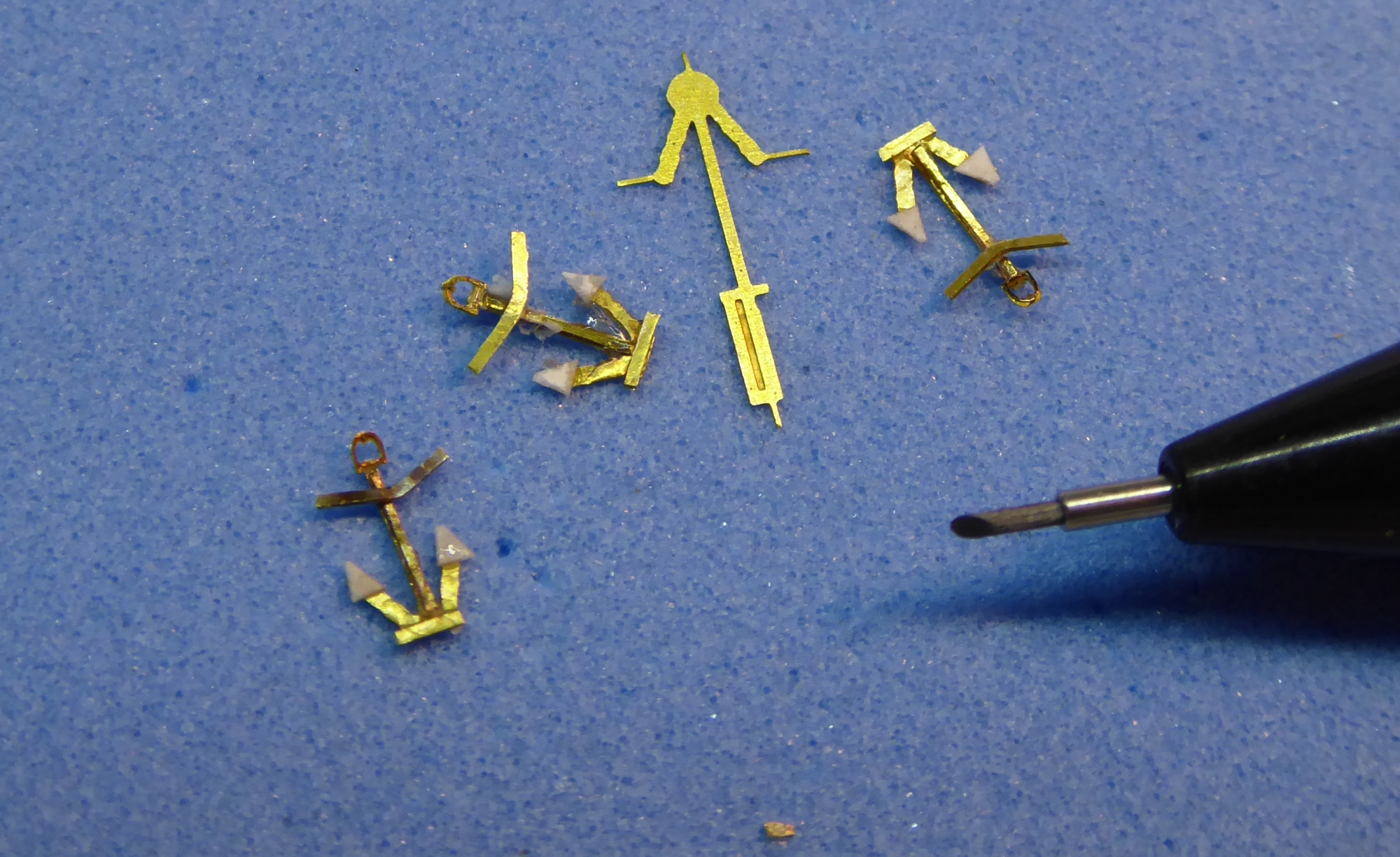

Before the stanchions were to be installed I needed to install 3 x anchors
the Kit had some quite well proportioned anchors-.....
-if a trifle too large for the anchor beds--
and anyhow almost inseparable without damage and breakage from the resin base
so I made my own-using redundant elderly PE semaphores as a repeatable starting point
