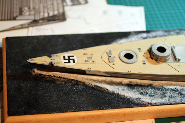

The kit has been waterlined, painted, and the wooden deck and PE details placed. Chains added as well. Swastika background made by cutting a circle with an Olfa cutter on 40mm Tamiya tape and using it as a mask. The swastika itself is a decal from a 1/48 aircraft decal sheet. Already unhappy with the wooden deck. Too thick for my taste, and great difficuly in placing it. Its adhesive does not allow corrections, and placing it even a fraction of a millimeter incorrectly will haunt you later, as other pieces either will not fit or leave gaps.

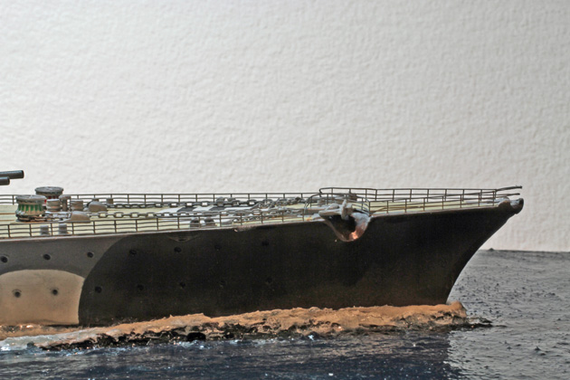

Bow and anchors, which brings me to Part II of my rant about the Ka deck: it does not provide/include the different plank pattern which existed between the capstans and the extreme bow. If I recall correctly, the kit is incorrect in that as well. Eduard does provide the correct part, but.... it is PE! How do you match the paint with the wooden deck??? Simple: paint the wooden deck as well.... (which defeats the point of having a wooden deck, doesn't it?) That was the first crisis of the build.

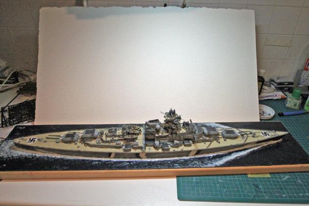

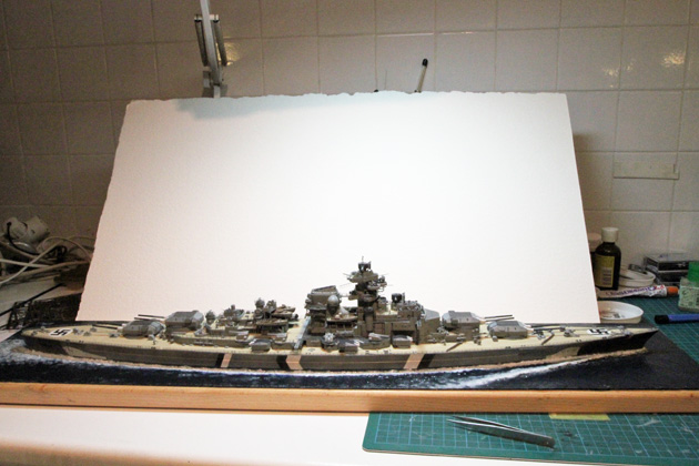

Base prepared and ship glued on it with epoxy glue. A 1/700 old bismarck model is shown for size perspective!

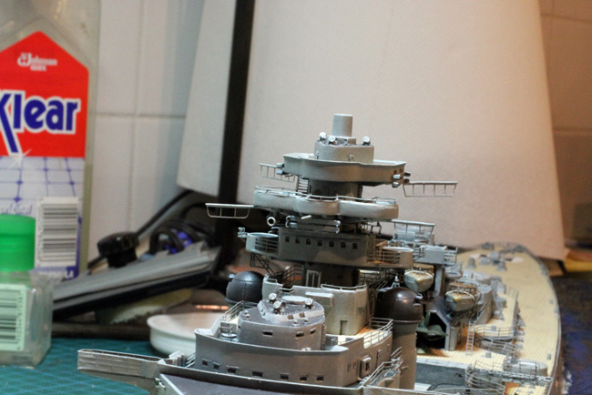

Front superstructure -the troublesome one. Among the things I failed to realize, is that both the semicircular structure behind the front 5.9 inch guns and the side of the main bridge structure (both form the second superstructure deck) should be seamless extensions of the first superstructure deck. Well, I had seams... very obvious seams... and i had to remove those seams... so I had to remove a lot of carefully placed PE work, putty the area, sandpaper VERY carefully to minimize collateral damage, replace the PE work, and then repaint and weather so as to blend everything together again. :Mad_6: A stiff drink was definitely required after all this...

Another view of the rear superstructure
The PE railings at the top level were later removed, as I could not make them sit properly. I did like the kit-provided foghorn -which had to be drilled- located over the Admirals bridge.

It is now time for the pictures of the ship at its present build stage. The ship is now basically complete. All subassemblies have been glued to the hull, and most final corrections have been made. It is still missing the masts, the aft director and the cranes. I also intend to make a few more corrections (the camera does not lie unfortunately...) and add some crew figures. So:
overall view
File comment: Bow detail
