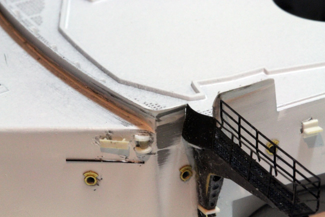

Eduard PE on barbette face. Fiddly but nice. Did I mention that an Optivisor at X2.5 is a must???

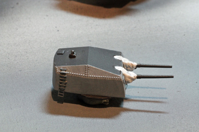

The blast bags were made with Tamiya 2-part epoxy putty, sculpted when still malleable and then painted and weathered.

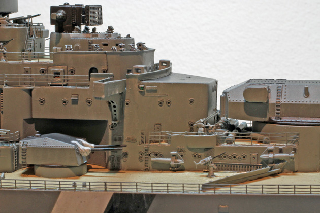

Working on superstructures. All doors and scuttles replaced with Eduard and WEM PE

Another view of the rear superstructure
The PE railings at the top level were later removed, as I could not make them sit properly. I did like the kit-provided foghorn -which had to be drilled- located over the Admirals bridge.

It is now time for the pictures of the ship at its present build stage. The ship is now basically complete. All subassemblies have been glued to the hull, and most final corrections have been made. It is still missing the masts, the aft director and the cranes. I also intend to make a few more corrections (the camera does not lie unfortunately...) and add some crew figures. So:
overall view
File comment: Bow detail
File comment: Anton and Bruno turrets
