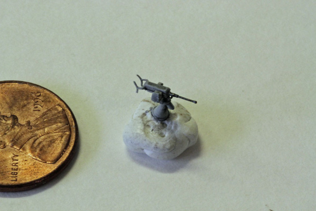

20mm AA with Eduard PE and Master brass barrel
The infamous Army 20mm mount with a master barrel

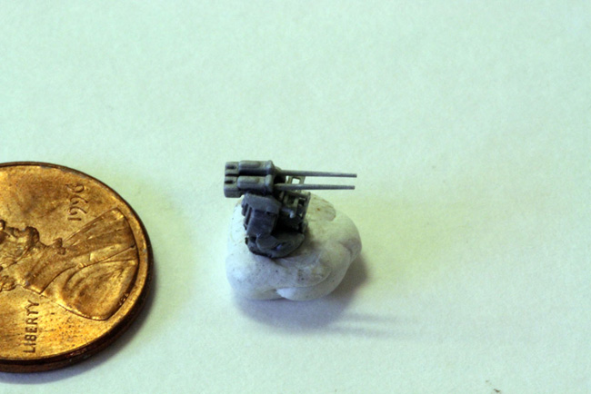

37mm twins with Eduard PE and Master barrels

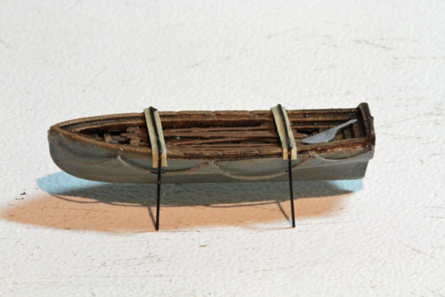

Now, boats! Inspired by the work of fellow member Stefano Salesi in the WIP thread, I went all the way: all plank detail was sanded off and replaced by planks cut from a sheet of the same wood (veneer?) wooden decks are made from. In retrospect, i am not sure it was worth it, as not much can be seen, but it does make a difference. Parts from PE stairs were also used, as well as the relevant Eduard PE parts and wire.
11m launch
