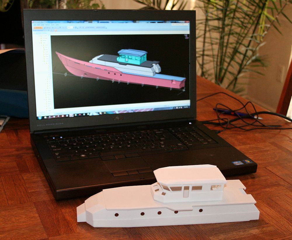

I just received another shipment of parts- the main cabin, pilot house, and roofs. These are done in Shapeways SLS (sintered nylon)... which is not best for fine detail parts, but works well in larger structures like these, where I can fill and sand the surfaces. See the close-up, you can see the typical layering.
Next order on the way- mast, crane, skegs/props, all in the finer Objet resin.
PM
File comment: The Plan, The Parts

PostPosted: Wed May 08, 2013 2:39 pm
Joined: Fri Jan 21, 2005 8:24 pm
Posts: 415
Location: Michigan
A few more printed parts arrived...
Grrr... the crane assy had some parts broken off the sprue... my bad, weak sprue... hope to get them replaced soon.
Grrr #2... Shapeways insists on jamming delicate parts into tight fitting and stiff plastic bags... even after I asked them not to, for the mast assy. It arrived in one piece but warped. I should be able to straighten it with hot water... if not, I may need to work in brass...

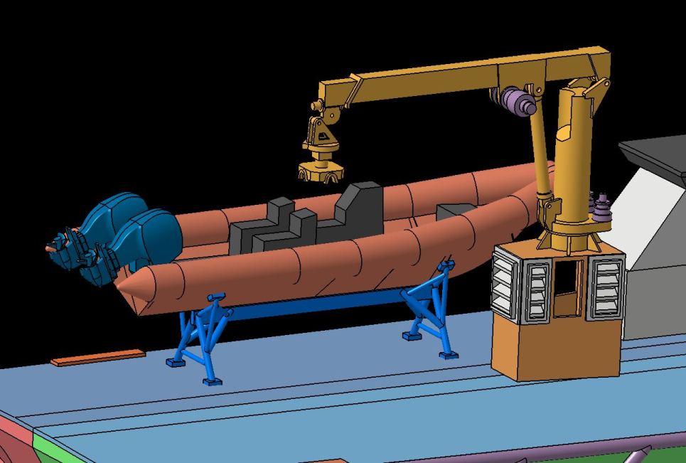

Still drawing parts... lots of progress, but not done yet! Everything in the images is 3D-printable though.

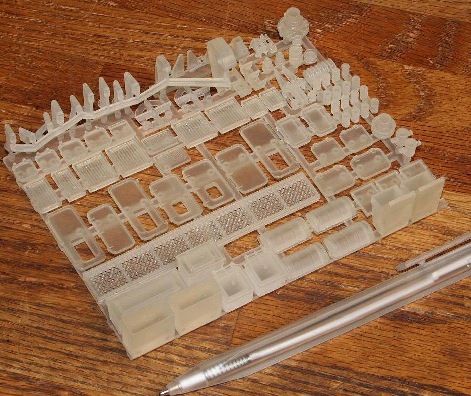

If you open a big 1:72 kit box (like the Revell Flower), you're confronted with sprue after sprue of little parts.
This project is no different, except that I can do things with my sprues that no injection die could handle... which reduces the number of sprues, if not the number of parts. Here are some of my latest, now on order:

Just received the parts pictured 2 posts above... As received, still oily/waxy.
I'm pretty happy with this lot... A few more parts to order yet, but not much excuse left, I need to start putting it all together now!
Shapeways Frosted Ultra Detail (Objet, highest resolution).
File comment: A sprue of parts
