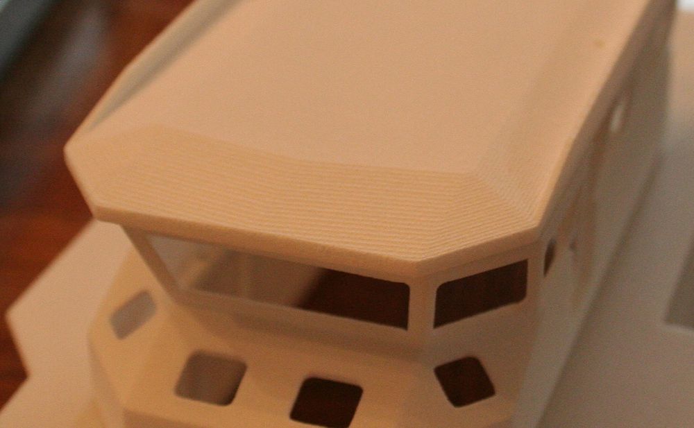

I just received another shipment of parts- the main cabin, pilot house, and roofs. These are done in Shapeways SLS (sintered nylon)... which is not best for fine detail parts, but works well in larger structures like these, where I can fill and sand the surfaces. See the close-up, you can see the typical layering.
Next order on the way- mast, crane, skegs/props, all in the finer Objet resin.

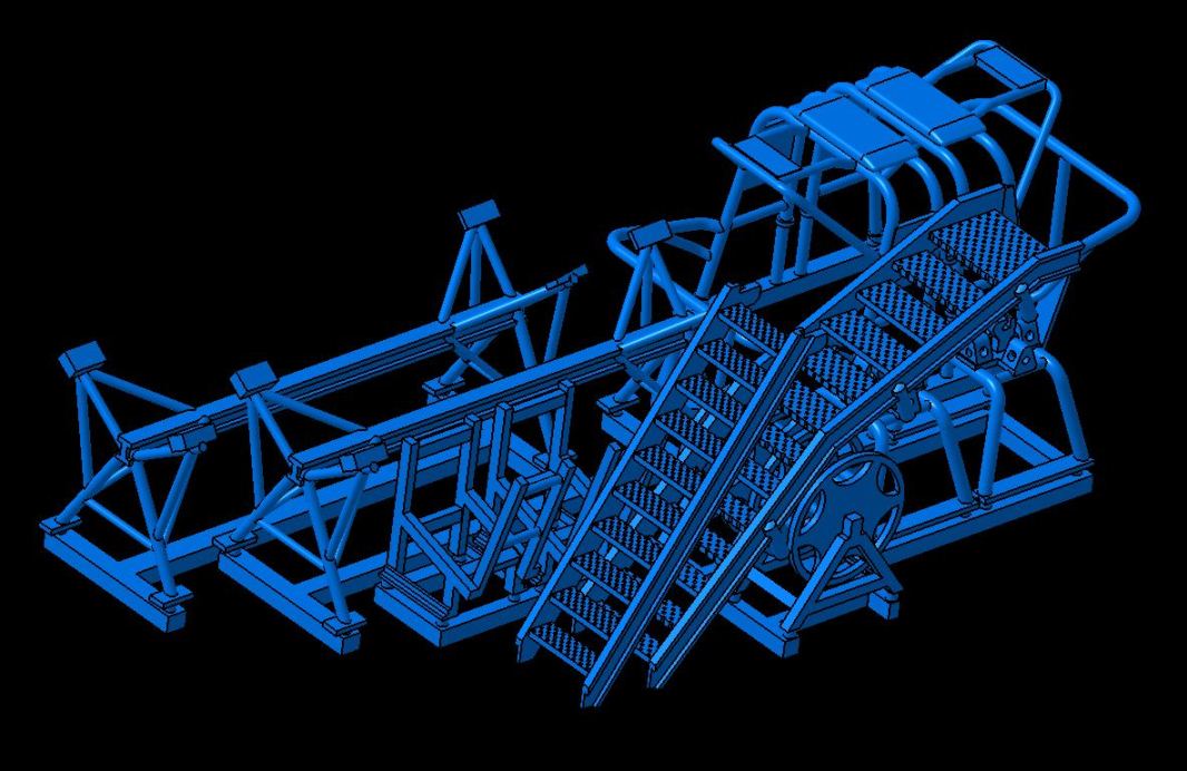

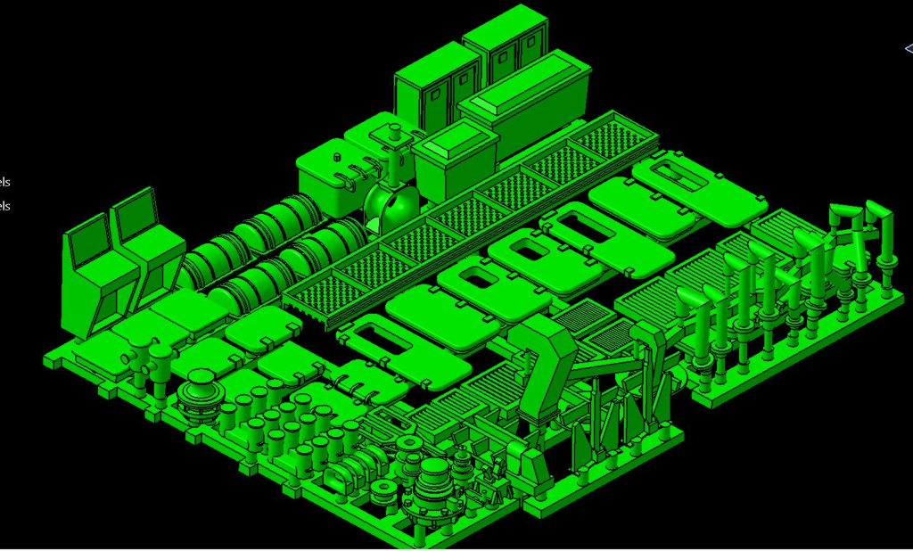

Still drawing parts... lots of progress, but not done yet! Everything in the images is 3D-printable though.

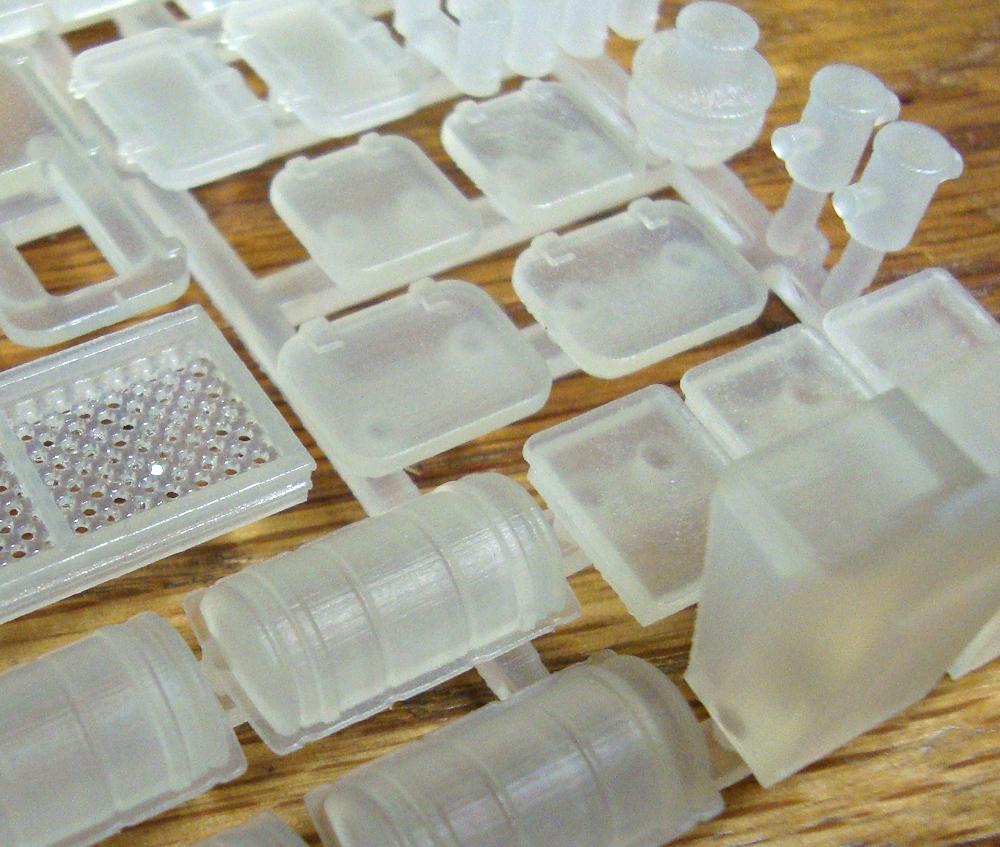

Just received the parts pictured 2 posts above... As received, still oily/waxy.
I'm pretty happy with this lot... A few more parts to order yet, but not much excuse left, I need to start putting it all together now!
Shapeways Frosted Ultra Detail (Objet, highest resolution).

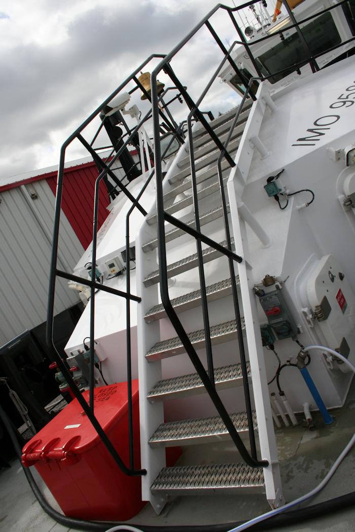

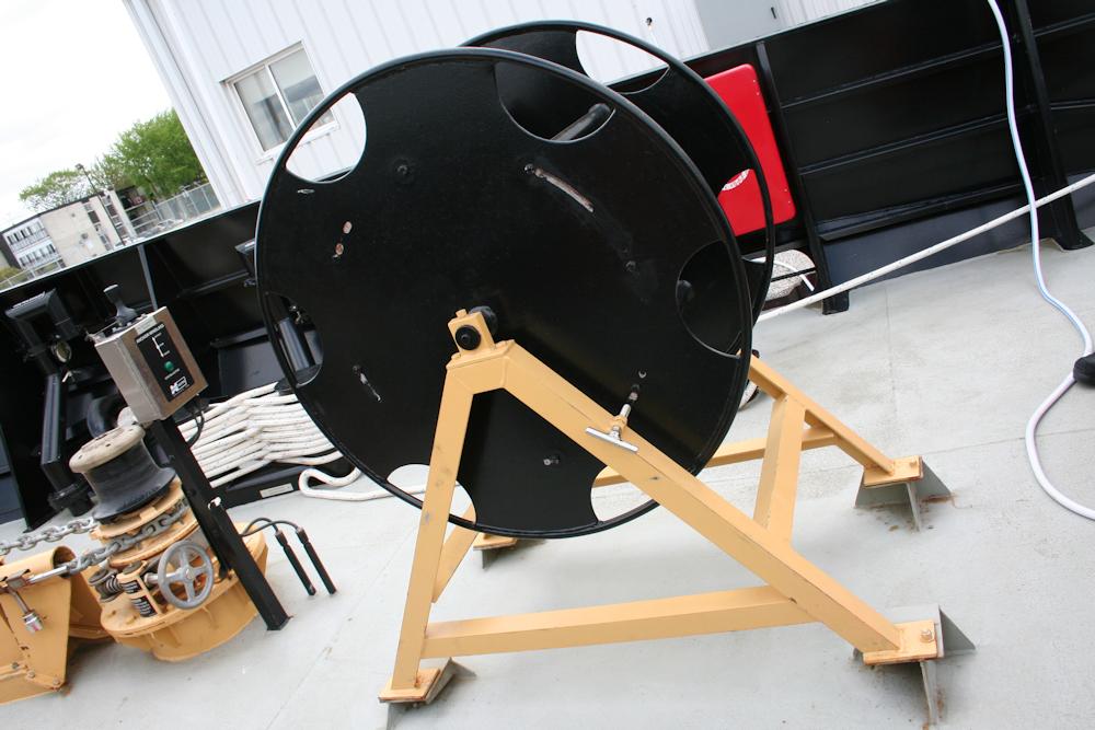

And a few 1:1 pics for comparison...
