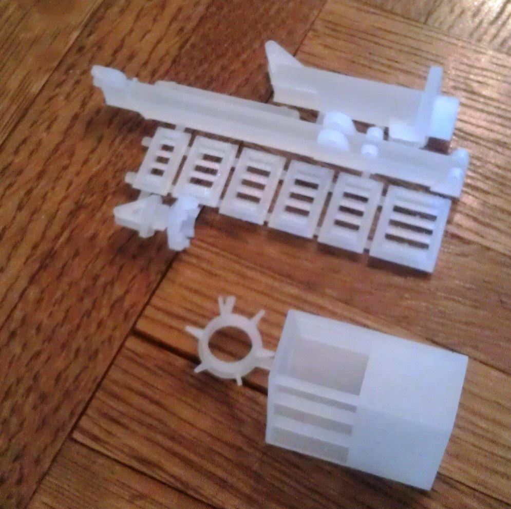

A few more printed parts arrived...
Grrr... the crane assy had some parts broken off the sprue... my bad, weak sprue... hope to get them replaced soon.
Grrr #2... Shapeways insists on jamming delicate parts into tight fitting and stiff plastic bags... even after I asked them not to, for the mast assy. It arrived in one piece but warped. I should be able to straighten it with hot water... if not, I may need to work in brass...

Looking good. As far as the damage, try adding thick support structures around the parts to protect them.
Timothy Dike
Owner & Administrator
ModelWarships.com
PostPosted: Wed May 08, 2013 9:32 pm
Joined: Fri Jan 21, 2005 8:24 pm
Posts: 442
Location: Temecula
I'd love to... but the part cost goes by material volume... and this was already $27 in the part alone, I'd treble the cost at least by printing a cage around it.
Another issue: Multijet printed parts (like this) are embedded in a block of support wax. Most of this is gently melted off, but they still go in and hand scrape a lot of it... and that process puts even protected parts at risk.
Better bet is to take the delicate parts off, and either make them from brass, or print them separately.

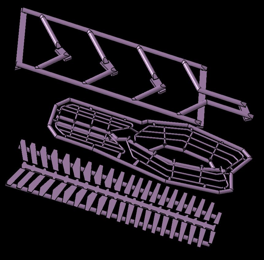

Still drawing parts... lots of progress, but not done yet! Everything in the images is 3D-printable though.
