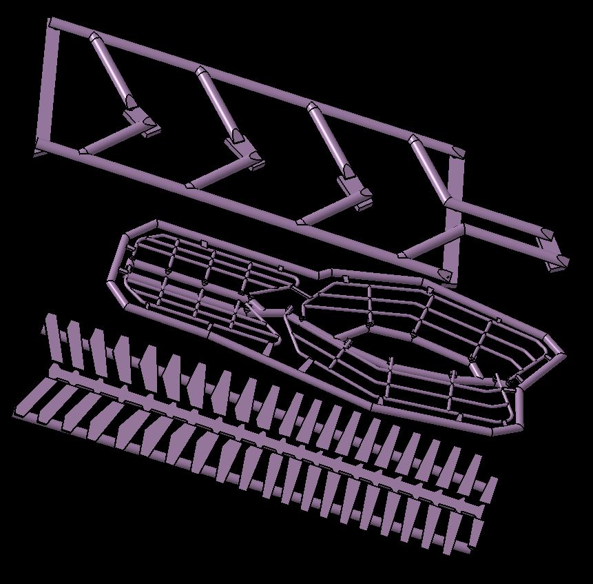

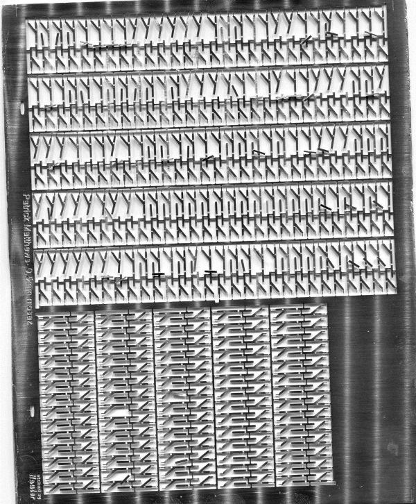

I asked in another thread about custom PE suppliers, and was told about Hauler in the Czech Republic. I sent them my drawing for stanchions, and a week later they had a sample sheet to show me. Had some issues- the small sized parts are sensitive to how the lines’ thicknesses are created, and we ended up with oversized rail holes and broken stanchions.
Incredible turnaround time though, and now we’re working with a modified design that should correct the issue.

PostPosted: Fri May 24, 2013 10:29 am
Posts: 2874
Initially I had the same problems, but with thicker and shorter lines I had no further problems. I'm going to get my new Hauler etch from the post office right now... :cool_2:
