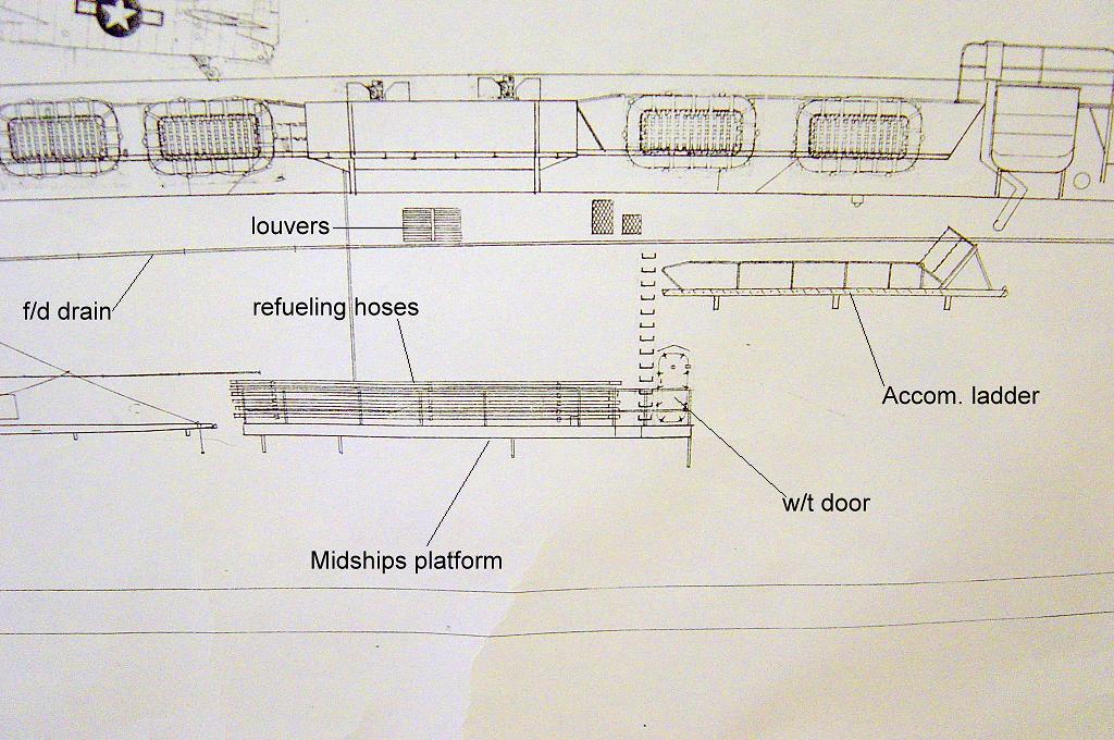

Hello again all :wave_1: Now that the hulls have been sealed with resin and gelcoat, I'll move on to details on the sides of the CVE hull. Since the carrier is a bit more involved than the DE, I felt I would start here 1st, putting the DE on hold for now. In this post, I thought I would go through the sequence of construction on these hull details for the CVE. The first place to start is with the drawings....Lets take a tour..........
File comment: One of the more challenging aspects here are the sponsons along the side of the hull. This is a top view of the sponsons and the midships platform, stb. side. I'll use these patterns for the styrene decks that are mounted to the sponsons.
File comment: Here's the aft sponson from portside. I've noted some details that I will add.
File comment: The forward sponson layout, again from port side.
File comment: Midships platform from port.

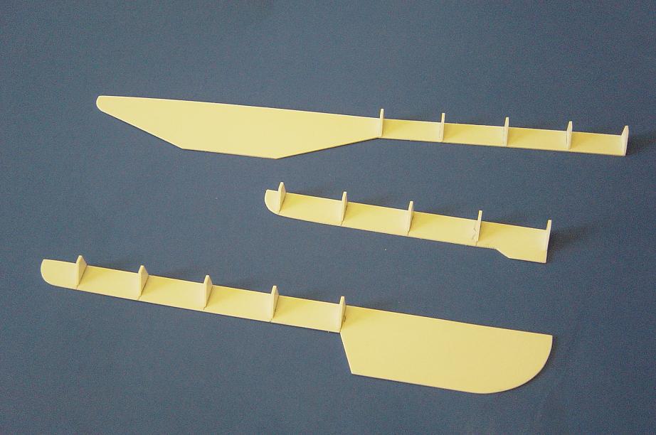

File comment: Using the patterns, I have cut out the parts from the materials I'll be using here. Balsa for the sponsons, .030 styrene for the decks, platform and supports.

File comment: The aft sponson is a bit less complex in shape than the forward one. Here I have shaped a balsa block for the aft sponson, adding the styrene strip as before. Shown here in it's relative position along the hull.

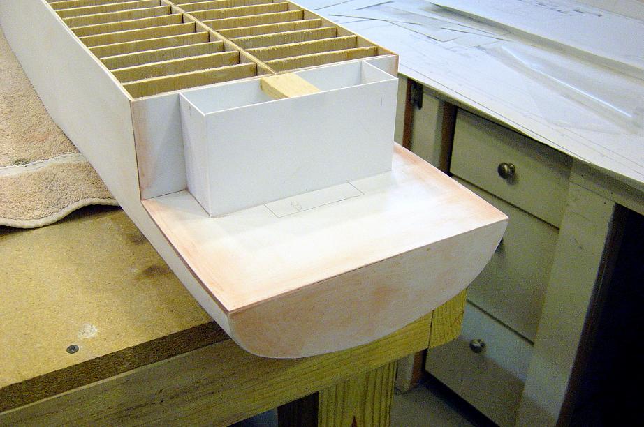

File comment: Forward sponson installed. Note those recessed openings.
File comment: Another view.
File comment: Due to the shape of the hull, the fwd. sponson does not fit quite right. I have masked it off here and have applied filler to get rid of any small gaps between the sponson and the hull side joint.

File comment: Midships platform now installed. I have added an ABS railing.
File comment: Fwd. sponson deck installed and railings added.
File comment: Aft sponson deck installed and railings added.
File comment: Accomodation ladder added, as well as w/t door and ladder. I fabricated the acc. ladder from some spare parts.
File comment: Ladders and a cast metal lifering added to fwd. sponson area.
File comment: Lastly, I have added the 35' boat boom. Tapered wood dowel used here. Pinstripe tape used to simulate the metal rings around the boom and some small steel eyelets added.
