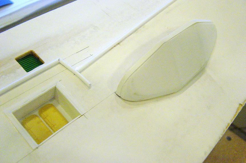

File comment: Along the hull sides, there are several recessed openings. Two are above the fwd. and aft sponsons, and are access ways to the hanger deck via double w/t doors. The others, 4 in all, are louvers which have fans behind them for hanger deck ventilation. I have marked their locations along the hull, and will now cut these out.
File comment: Using a Dremel with a small router bit, I carefully cut out the openings using my lines for a reference.
File comment: The opening for the double w/t doors now cut out and trued up with a file.
File comment: To make the recessed areas for the doors, I fabricated a simple box from .030 styrene, leaving one side open. I then added a small flange around three sides of the box, from.010 styrene, then the two w/t doors, resin cast by me. I'll make four of these all together, two on each side. This is now ready to install.
File comment: Here is one of the louver openings. The louver itself is a Lego part, works great here. I'll glue this behind the opening. There are eight of these in total, four on each side.
File comment: Doors and louvers now installed.
File comment: I'll now add the flightdeck drain pipe. 3/32" styrene tube used here.
File comment: Drainpipe installed.

File comment: Midships platform now installed. I have added an ABS railing.
File comment: Fwd. sponson deck installed and railings added.
File comment: Aft sponson deck installed and railings added.
File comment: Accomodation ladder added, as well as w/t door and ladder. I fabricated the acc. ladder from some spare parts.
File comment: Ladders and a cast metal lifering added to fwd. sponson area.
File comment: Lastly, I have added the 35' boat boom. Tapered wood dowel used here. Pinstripe tape used to simulate the metal rings around the boom and some small steel eyelets added.
File comment: This and the following photos show everything completed and primed, ready soon for final paintwork. A few small details to be added as soon as I get them.
Well, there you have it. A step by step procedure on the hull sides. Not the only way to do this, just thought I would show how I do it. Stay tuned....more to come......I continue on............ :wave_1: :thumbs_up_1:
