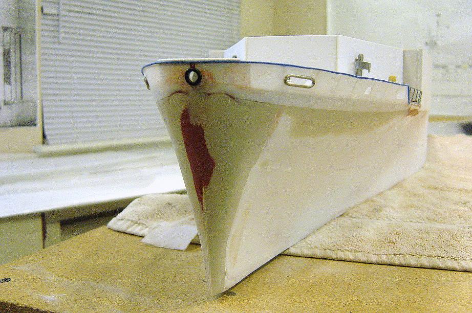

Here I have formed in the bow area of the DE with autobody filler, and shot a little primer on to check for imperfections, some of which you can see. I'll hit those with a little glazing putty, then sand and prime again.
Another view here. I applied the filler to the edge of the styrene strip I added earlier, to get that sharp edge line. Anchors are cast metal.
Overhead view of the DE bow.
The CVE's bow has now been formed in again using the body filler. Note the bulwark, fabricated from .010 styrene then blended into the hull with the filler. The red spot you see is the glazing putty I spoke of. Sort of like very thick primer, almost a paste. Some of the hawse lips have been added. "Cap" on top of bulwark is thin telephone wire.
Another view here. Bulwark is a tricky piece to do, even with .010 styrene. Difficult to get it to curve correctly in one piece, so I did it in three. Hull is made to be below the boot topping a little bit to show some red hull, when finished. You won't see much red depending on the water action. Anchor hawses and anchors yet to be installed.

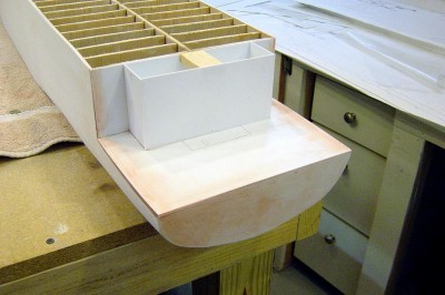

Hello again all :wave_1: Now that the hulls have been sealed with resin and gelcoat, I'll move on to details on the sides of the CVE hull. Since the carrier is a bit more involved than the DE, I felt I would start here 1st, putting the DE on hold for now. In this post, I thought I would go through the sequence of construction on these hull details for the CVE. The first place to start is with the drawings....Lets take a tour..........

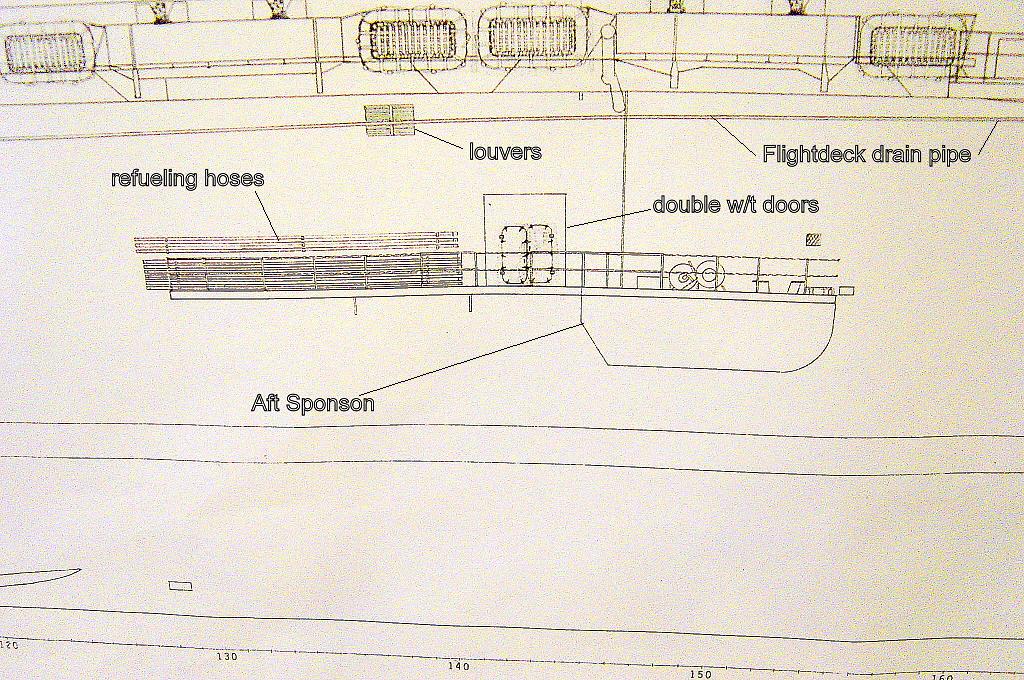

One of the more challenging aspects here are the sponsons along the side of the hull. This is a top view of the sponsons and the midships platform, stb. side. I'll use these patterns for the styrene decks that are mounted to the sponsons.
Here's the aft sponson from portside. I've noted some details that I will add.

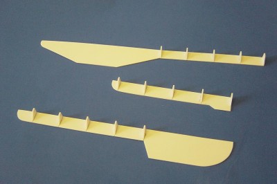

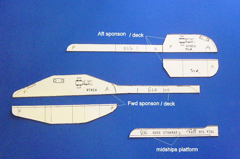

I have transferred the drawings to poster board, then cut them out as shown here. These will be the patterns for the decks and the sponsons themselves.
Using the patterns, I have cut out the parts from the materials I'll be using here. Balsa for the sponsons, .030 styrene for the decks, platform and supports.

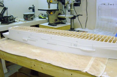

Again using the drawings for reference, I have drawn out the working lines here on the stb. side of the CVE hull. This is the aft sponson area.
Same procedure used here for the fwd. sponson area.
An overall view of the working lines, from stb. side.

Next, I have prepared some autobody filler and smoothed it all over the rough shape of this sponson. Before the filler is completly cured, sort of rubbery, I'll shape this out again using 80 grit paper, then follow with 220.
Sponson now shaped and sanded. I have added a strip of .010 x .125 styrene along the top edge.

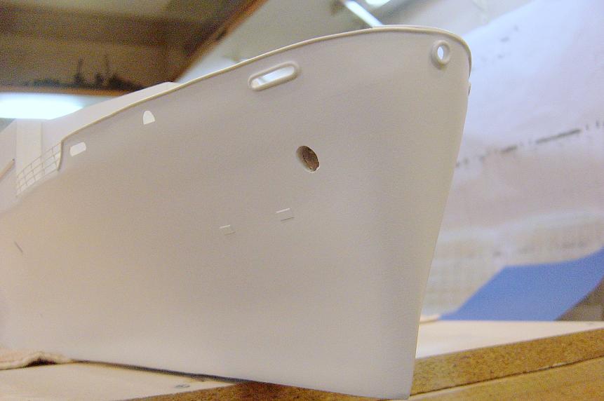

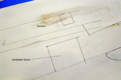

Along the hull sides, there are several recessed openings. Two are above the fwd. and aft sponsons, and are access ways to the hanger deck via double w/t doors. The others, 4 in all, are louvers which have fans behind them for hanger deck ventilation. I have marked their locations along the hull, and will now cut these out.
Using a Dremel with a small router bit, I carefully cut out the openings using my lines for a reference.

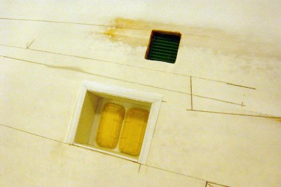

The opening for the double w/t doors now cut out and trued up with a file.

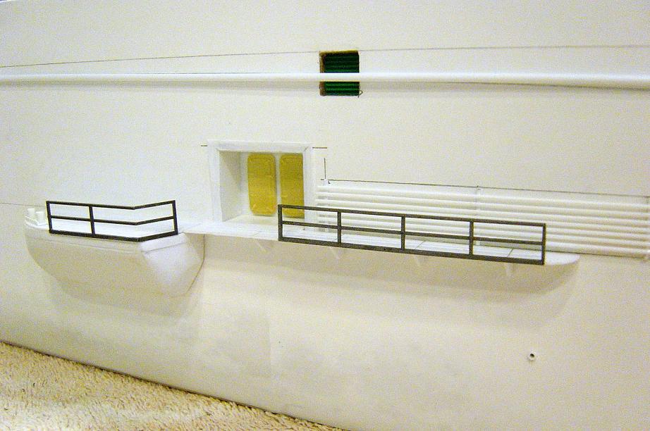

To make the recessed areas for the doors, I fabricated a simple box from .030 styrene, leaving one side open. I then added a small flange around three sides of the box, from.010 styrene, then the two w/t doors, resin cast by me. I'll make four of these all together, two on each side. This is now ready to install.

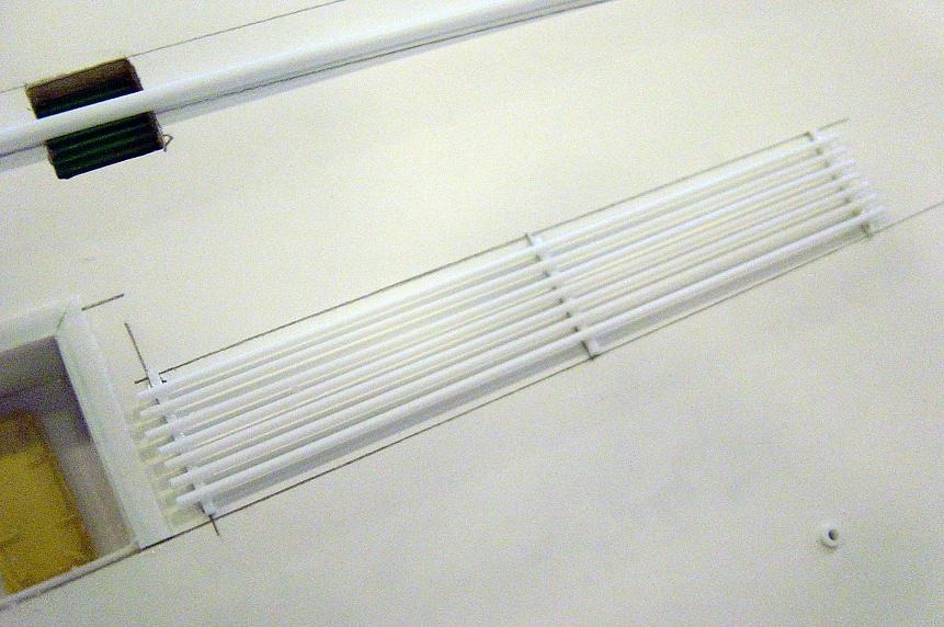

Here is one of the louver openings. The louver itself is a Lego part, works great here. I'll glue this behind the opening. There are eight of these in total, four on each side.
Doors and louvers now installed.

Next, I'll add the refueling hoses above the aft sponson deck and the midships platform. .040 styrene strip and .047 rod used here.
Aft sponson installed using 2 part, 6 minute epoxy.
Another view here.
Another view here.
Forward sponson installed. Note those recessed openings.
Another view.
Another view.
Due to the shape of the hull, the fwd. sponson does not fit quite right. I have masked it off here and have applied filler to get rid of any small gaps between the sponson and the hull side joint.
With the sponsons installed, I now add the supports under the decks and the midship platform, shown here.
Contact cement used here to attach the decks. This is the top of the fwd. sponson.
Apply the cement to the bottom of the decks, also.
Midships platform now installed. I have added an ABS railing.
Fwd. sponson deck installed and railings added.
Aft sponson deck installed and railings added.
