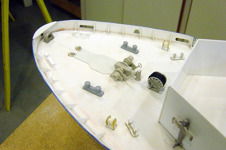

File comment: Forecastle deck details here. A mix of different materials used here. Styrene, cast metal, brass, etc. Again note the bulwark. Bracing is .025 styrene. Once the flightdeck is attached, you won't see much of this.
File comment: Another view here. A few more closed chocks to be added as well as the rest of the hawse lips. Forward 3 roller chocks were scratchbuilt using styrene strip and rod. I'll add anchor chains after paintwork. Deck is .040 styrene sheet, with 1/16" balsa beneath.

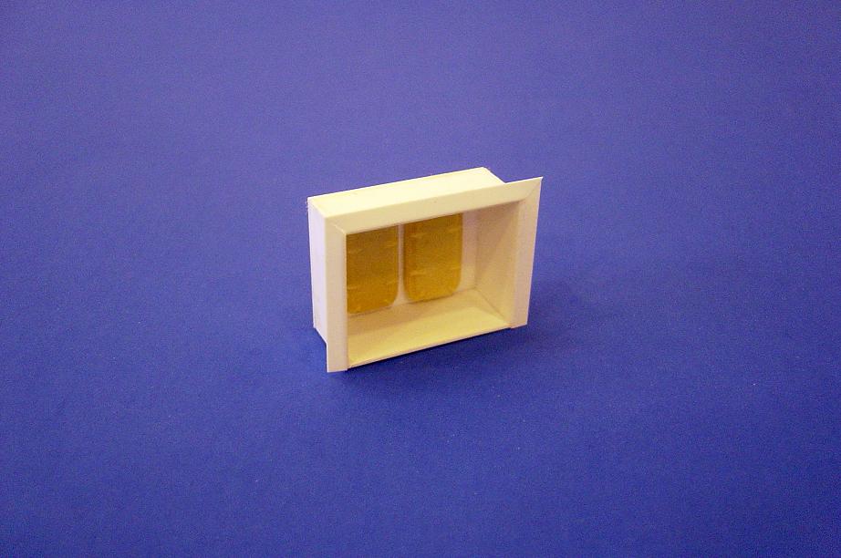

File comment: The opening for the double w/t doors now cut out and trued up with a file.
File comment: To make the recessed areas for the doors, I fabricated a simple box from .030 styrene, leaving one side open. I then added a small flange around three sides of the box, from.010 styrene, then the two w/t doors, resin cast by me. I'll make four of these all together, two on each side. This is now ready to install.
