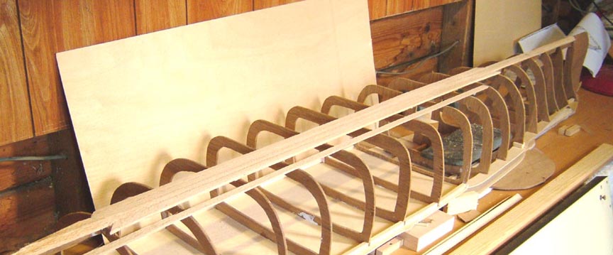

RIB SHAPES IN WOOD
We now copy the rib shapes on to our wood and cut them out,
The keel shape is cut out and stood up on a very flat board
Ribs are glued into place with water proof white glue, PVA

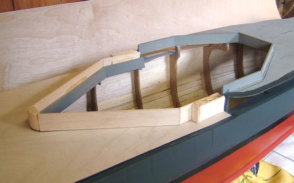

Now we are going to cut the access in to the deck, as a sailing model we need these to put in our batteries, radio gear and rudders also prop shafts. The hole needs an upstand to stop water getting in to the hull when on the water.

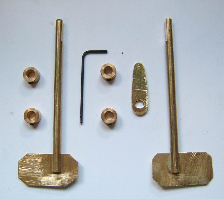

HMS IRON DUKE has 2 rudders, located behind the two inboard props, the first thing to do is put two hollow shafts in the hull in the correct position, behind the two inboard props, sticking out from the hull about 1/2 inch, but inside the hull you have to make sure they are at least 1 inch above the water line, this stops water from getting into the hull when the model is ballasted on the water, if not the water pressure is forced up the shaft and into the model, hence SINKING.
Then we cut two shafts and solder on a piece of brass plate
then make two arms and solder on two lock nuts, also cast a resin filla piece over the brass plates large enough for the rudders,
Mark and sand to shape,

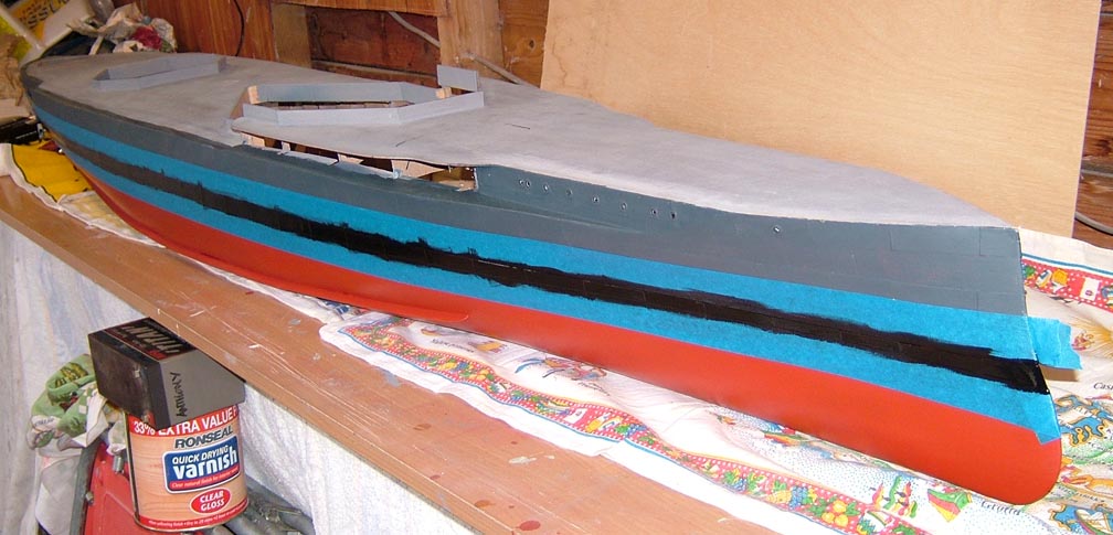

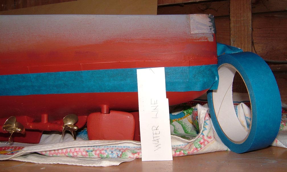

To put on the waterline and anti fouling, I make sure the model is level and mark on a piece of card the waterline.
Then with another card I mark on the anti fouling line.
Then I mask the hull and paint between the two tapes.
Before it begins to dry take off the tape and you should be left with a reasonable black line.

Continuation of the superstructure.
The first piece I cut today was a strengthening piece for under the deck, to lock everything together.
Section fitted, note the pins to give it strength.
The right way up, moved from opening.
Top , bottom and back of gun housing.
Second gun housing fitted to superstructure.
Deck cut and fitted.
The next level marked out and first sections glued in place.
The section complete.
Completed surround section with funnel in place for effect. All this balsa wood will have a covering over it for the finished paint work, also water tight doors and port holes.
enjoy ARH
