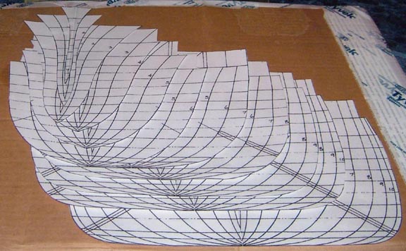

Getting rib shapes, scanned from drawings.
25 copied and cut out of paper
The wavey section as some one asked this the half breadth plan, it shows where the ribs fit along the hull.
enjoy. ARH

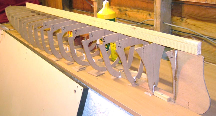

RIB SHAPES IN WOOD
We now copy the rib shapes on to our wood and cut them out,
The keel shape is cut out and stood up on a very flat board
Ribs are glued into place with water proof white glue, PVA
Simple but effective.

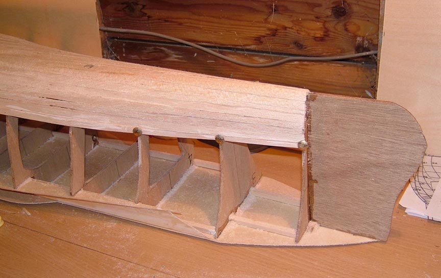

PLANKING THE HULL.
The first thing to do is turn the hull over so she is resting on her deck, also add some weights inside the hull when you first start planking
I use balsa wood 1/8 inch x 3/8 x 39 inches, and use water proof white glue to attach to the hull, were a joint on a rib is , it is cut on a diaganal, this gives a larger area to glue to.
I use house hold pegs to help told the balsa in place, also drawing pins
To get the stern shape I use solid balsa blocks and sand to shape.
Also I do the same at the bow. and then cover it with filla paste.
The hull is covered with very fine fibra matting and resin brushed in to it and left to dry.
The whole hull is then covered with filla paste and sanded to shape, using fine sand paper, and finished off with a wet and dry paper, use lots of water to get a good finish.
When the hull is dry you can give it a few coats of under coat paint, sanding between each coat.
enjoy. ARH

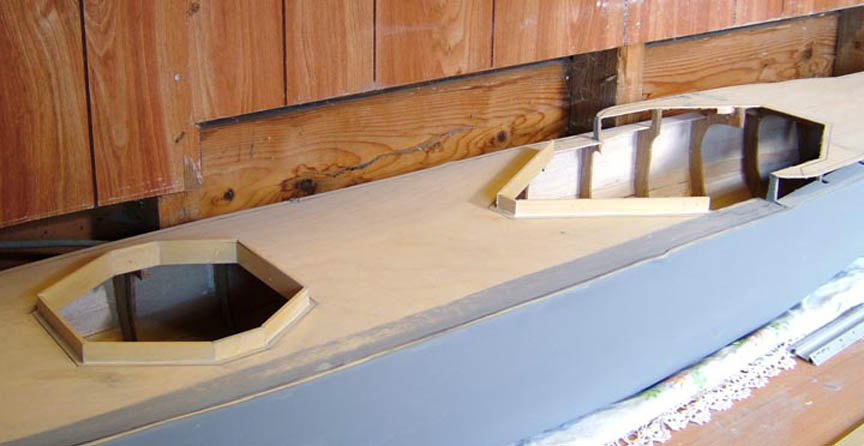

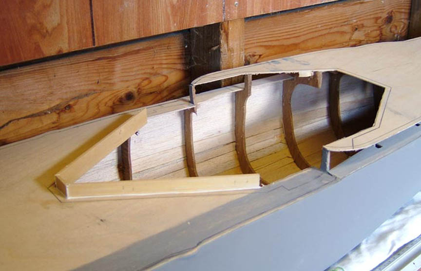

HULL PART 2
Now we are going to cut the access in to the deck, as a sailing model we need these to put in our batteries, radio gear and rudders also prop shafts. The hole needs an upstand to stop water getting in to the hull when on the water.
Now we are going to plate the hull, this is done using litho plate, a waste product from the printing industry, it's a very soft aluminium plate attached to the hull with contact adhesive. Having studied all my photo's I worked out where the plates needed to run.
Here you can see some of the WEM paints needed for the model.
Next I fit the bildge keels, these are plastic angle , glued and pinned in position.
Here you can see every thing I have done in the post.
enjoy, ARH

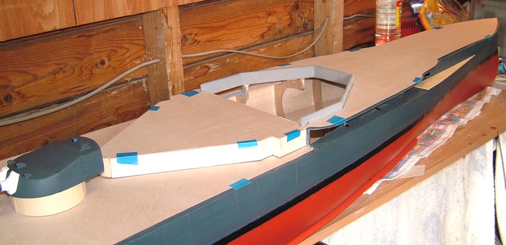

Hi Guys, IRON DUKE had her 4 props fitted, these are 30mm, left and right handed from PROP SHOP in the UK.
As you can see there's not a straight section on the hull
WATERLINE.
To put on the waterline and anti fouling, I make sure the model is level and mark on a piece of card the waterline.
Then with another card I mark on the anti fouling line.
Then I mask the hull and paint between the two tapes.
Before it begins to dry take off the tape and you should be left with a reasonable black line.

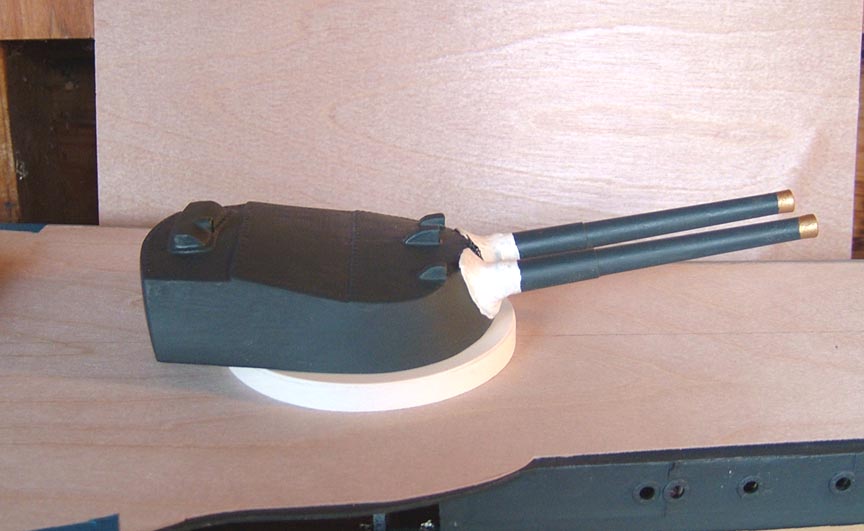

Here's the hull with the sub deck, and one of the turrets just positioned to give some effect
enjoy ARH :wave_1: :wave_1:

Start of Superstructure. First off I purchased 2 sheets of 1/64. ply 4ft x 1ft, this was cut to shape and fitted to both decks, this is the starting place for planking the decks, but it has to be cut and shaped around the access openings.
I also purchased 2 sheets of balsa wood 1mtr x 100mm x 2mm this will form part of the superstructure, I measured the height of the boat deck and cut my timbers and glued them in position around the opening, not forgetting to leave a packing piece in place so there will be room left to be able to remove this deck for access.
I then cut more balsa for struts to strengthen the deck.
Deck in position, taped down till glue has set, the balsa will have a covering over it later, either in thin ply or plastic card.
Bow view
Stern view, with three turrets placed in position for effect.

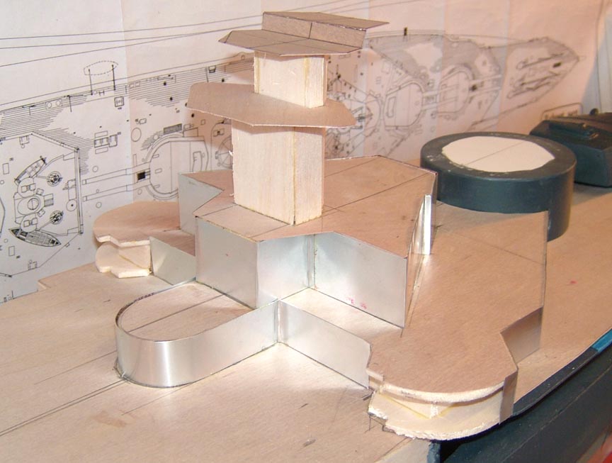

Well Guys, just a little bit more today, we continue on the superstructure, I have put in the floor for the main tower, strengthened it underneath because of the weight when everything is assembled,
Main tower
This is the first platform, just placed in position.
The second platform.
Third platform this one has a stepped section.
All the platforms will have angled strengthening sections built underneath.
Long shot of whole superstructure, this is only the starting point, there is a lot of covering up to do, portholes, door, ladders, handrails, dodgers, lights, and paintwork. :woo_hoo:
