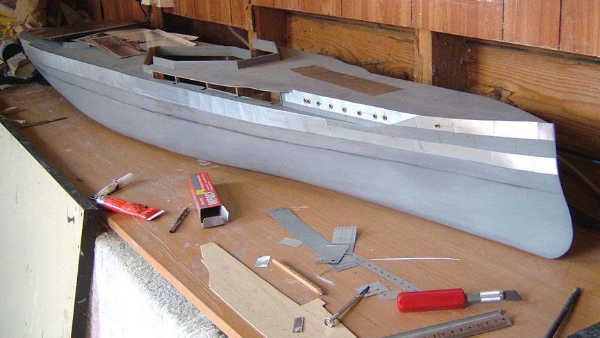

Now we are going to plate the hull, this is done using litho plate, a waste product from the printing industry, it's a very soft aluminium plate attached to the hull with contact adhesive. Having studied all my photo's I worked out where the plates needed to run.

Here you can see every thing I have done in the post.
enjoy, ARH

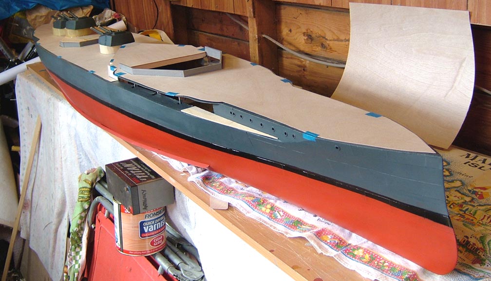

2 shots of the hull with its red primer and hull colour, as of 1916, Battle of Jutland.
enjoy, ARH :woo_hoo: :woo_hoo:

Start of Superstructure. First off I purchased 2 sheets of 1/64. ply 4ft x 1ft, this was cut to shape and fitted to both decks, this is the starting place for planking the decks, but it has to be cut and shaped around the access openings.
I also purchased 2 sheets of balsa wood 1mtr x 100mm x 2mm this will form part of the superstructure, I measured the height of the boat deck and cut my timbers and glued them in position around the opening, not forgetting to leave a packing piece in place so there will be room left to be able to remove this deck for access.

Deck in position, taped down till glue has set, the balsa will have a covering over it later, either in thin ply or plastic card.
Bow view
Stern view, with three turrets placed in position for effect.

I had an hour and a half of building to day, I have now started to cover the superstructure with LITHO PLATE, I spoke about this material before, it is a soft aluminium plate that is waste product in the printing industry, it very easy to cut and bend, I glue it on with Evostic contact adhesive.
As you can see, you can get sharp edges and sweeping curves very easily, the piece from the sanding block to the gun implacement is all in one piece.
