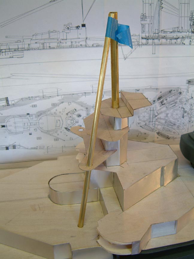

Hi Guys, One hour to day, I got the first deck platform drilled to take part of the tripod mast, also drilled out for the main mast and glued it in position,
The main mast is brass tube 10 mm wide, the angled leg is brass 6mm wide, it is drilled in to the deck and passes though the first platform, you can see the hole drilled on the opposite side of the platform.
The block of wood is steadying the first platform while work is in progress
Both legs are glued in position and are left to dry,
Long shot of to-days work.
enjoy, ARH :wave_1: :wave_1: :thumbs_up_1:

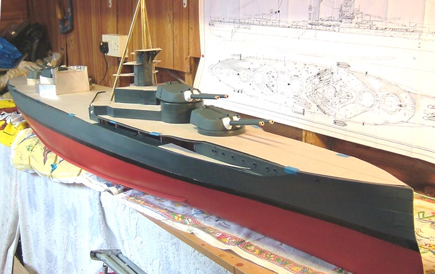

First of all I have weighed the ship model and it came out at 10lbs, that's with all the turrets on.
As to the camber of the deck, you can see it in this picture, 1/8 inch balsa under the rule either side,

Full view of model, all 5 turret's, second one needs the blast bags moulding and all painting and P/E fitting. :woo_hoo: :woo_hoo:

Hi Guys, Tonight we continue to plank the deck. As you can see I use a little weight to hold the edges down till the glue dries.
14 more planks laid on the opposite side, these 14 planks took 35 minutes to cut, put on the tape, mark out and lay.
We have now run 1 long piece though and are working back to the centre line.
Replaced the barbette and the guns.
A shot from behind the superstructure.
The deck can be lifted off the model, I prefer to be able to do this, as the years go on a sailing model needs a repaint, it's far easier to be able to paint and replace, it helps to keep all your deck lines clean.
That's the whole of one side of the forecastle finished.
The first part of the deck has been lightly sanded, hence the lighter shade, today's work is still darker.
There is a lot of decks to do, but the contrast in colour between the decks and the superstructure should highlight what would be a dull model.
Simple but effective.
