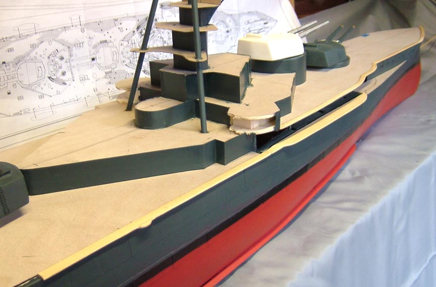

 Post subject:
PostPosted: Sat Oct 08, 2005 5:15 pm
Posts: 2557
Hi Guys, My timbers arrived this week, so I have made a start on the margin planks at the edge of the deck.
First the flat sections of Eurpean Lime and 150 3mm x 1mm x 1mtre deck planks.
To get the awkward shapes I put the timber under the deck and mark around, cut that side and then scribe out the same shape 3/8 of an inch away and cut, using a good sharp blade #11
The timber is glued in position with compact adhesive, leave to dry slightly before putting in position.
Down by the casement guns it is a little wider, it actually overhangs the hull quite a bit.
A bow shot, beginning to take shape.
A stern shot, note the 12 casement barrels, made by Steve Nuttall.
enjoy, ARH :wave_1: :wave_1: :thumbs_up_1:

Deck Planking,
We have already laid the 1/64 ply on the deck, now we have to cut and shape the combing and margin planks.
This is how I mark out the combing, I slide it under the object and mark around it, then cut at that point,
Continue till you have done all margin planks in that area.
For the pitch between the planks we are going to use black electrical tape, sticky on one side. Roll out the tape, sticky side up, turn your planks on edge and press them on to the tape.
Now turn them over and rub your fingers over the tape to make sure it is stuck to the planks
With a #11 blade put it between each plank and gently slice each plank away from each other.
You should now have 13 planks with a thin layer of tape attached.
Now we start laying them. I have marked the centre line and laid a rule along it, next we put down some PVA white glue and lay the first 5 planks.
I have cut another 5 planks and tried them in position, marked a line to show me were to put the glue to.
PVA in position, ready for planks.
A bow shot of all the planks laid.
This is only the beginning of the planking, there,s a long way to go, the planks laid are very long you may say, they will get divided into 20 ft scale lengths later, and all hatches will be marked and cut out, also it has to be sanded and treated to water proof it.
enjoy, ARH. :wave_1: :wave_1: :thumbs_up_1:

Hi Guys, Tonight we continue to plank the deck. As you can see I use a little weight to hold the edges down till the glue dries.
14 more planks laid on the opposite side, these 14 planks took 35 minutes to cut, put on the tape, mark out and lay.
We have now run 1 long piece though and are working back to the centre line.
Replaced the barbette and the guns.
A shot from behind the superstructure.
The deck can be lifted off the model, I prefer to be able to do this, as the years go on a sailing model needs a repaint, it's far easier to be able to paint and replace, it helps to keep all your deck lines clean.
That's the whole of one side of the forecastle finished.
The first part of the deck has been lightly sanded, hence the lighter shade, today's work is still darker.
There is a lot of decks to do, but the contrast in colour between the decks and the superstructure should highlight what would be a dull model.
