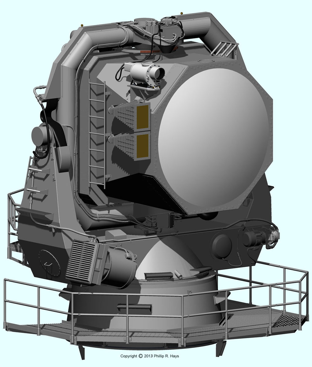

Here is my model of the AN/SPG-49 missile tracking radar antenna. It was a 22 ton behemoth 18 feet (5.6 meters) high and 17 feet (5.2 meters) wide. This thing was a project in itself that took months to finish, and the file size is about 50 Mbytes. I visited the USS Little Rock CLG-4 museum ship in Buffalo, NY, and made photos and took measurements so get the size correct. I haven't found any plans for this antenna, but since I have started on the model the Navy has declassified and released documents for the Talos missile system to the National Archives - about 15,000 pages! Maybe someday I will visit the archives and go through all of that stuff.
This is actually the second model I made. The first was done entirely by photoguestimation from pictures. After I visited the Little Rock I started over with an entirely new model. It should be accurate to half an inch (10mm) or better.
Unlike most radars that have the electronics below decks with wave guides connecting to the antenna, the 49s had all the transmitting and receiving electronics inside the antenna - along with four axis training motors, hydraulics and cooling systems. It was actually two separate C-band radars in one assembly, a 3 megawatt monopulse tracking radar and a 5 kilowatt continuous wave target illumination radar, with horizontal and vertical scanning and polarization mechanisms for the beams. It was an adaptation of the FPS-16 land based radar that was used to track satellites and spacecraft. It's scan range was deliberately limited to 150 miles, although it could easily have tracked the moon.
When Apollo spacecraft were on the way to the moon we received orders to not radiate (we could have tracked them easily while they were in orbit). The Apollos used C-band communications and the 49s would have interfered with communications at the least, and they might have damaged the spacecraft's sensitive high gain receivers.
This model includes everything down to 3/16" (4.7 mm) diameter rivets.

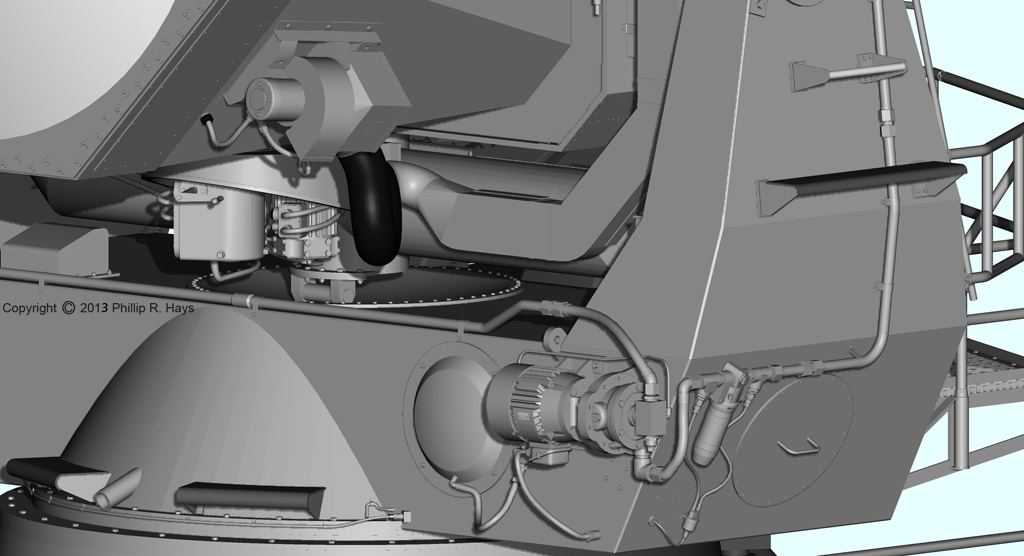

Here are some detail pictures. I am posting these in case someone else wants to build one of these. It has taken me years to accumulate detailed photos of intact assemblies.
The first two are of the gimbal drive mechanisms on the yoke. The side plates, motors and tachometers/servo mechanisms are missing from the units on the Little Rock. They were stripped for use on other Talos ships when the Little Rock was decommissioned. I finally accumulated enough close-up photos to be able to reconstruct the missing pieces.
The top detail image shows the two antenna traverse drive motors on the gimbal, and the "C" shaped gear on the antenna housing that the motors drove. It also shows the TV camera on the antenna.
The bottom detail shows the second pair of traverse motors on the bottom of the gimbal, a hand crank gear to manually position the antenna, cooling fan on the antenna housing and the coolant pump on the yoke.
This thing was easily the most complex single part of the whole ship model.
