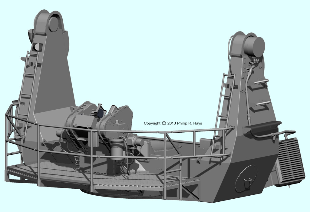

The AN/SPG-49 had four major components.
The base supported the antenna and mounted it to the ship's structure. It was positioned to +/- 0.015 inch (0.4 mm) accuracy during ship construction. The base contained a drive motor to rotate the yoke.
The yoke rode on the base and rotated around the vertical axis (azimuth). It supported the gimbal. The yoke carried dual drive motors to rotate the gimbal.
The gimbal rotated around the horizontal axis (elevation). It supported and antenna housing and carried four motors to rotate the antenna. The large "C" shaped feature is a gear that was driven by the motors on the yoke.
The antenna housing also rotated around the vertical axis (azimuth). The yoke rotated relatively slowly to aim the antenna in the desired direction. The antenna could slew back and forth quickly (traverse) to correct for ship motion in high seas. The front surface of the antenna was a Luneberg lens that focused the C band RF energy into the receiving horns at the back of the housing.
The back of the housing had two "clamshell" doors that opened to allow access to the guts. One of the fellows who worked on the 49 said there was enough room inside the antenna for a couple of fellows to have a tea party. The transmitting klystron was 4-5 feet tall and water cooled. A lot of the pumps, plumbing and fans on the outside of the antenna were for klystron coolant. There were two feed horns on the right side. One was a CW "spoiler" that scattered some energy in a different pattern from the main lens to fill in low power lobes in the antenna pattern. The other was a side lobe suppressor to prevent jamming.
The base, yoke and gimbal were pretty much the same for both Talos and Terrier systems, but the antenna housings were different.
When I build the physical model I intend to construct it with these four subassemblies so it can rotate through all axes. At 1:96 scale the antenna will be 2.25 inches (57 mm) tall.

Here are some detail pictures. I am posting these in case someone else wants to build one of these. It has taken me years to accumulate detailed photos of intact assemblies.
The first two are of the gimbal drive mechanisms on the yoke. The side plates, motors and tachometers/servo mechanisms are missing from the units on the Little Rock. They were stripped for use on other Talos ships when the Little Rock was decommissioned. I finally accumulated enough close-up photos to be able to reconstruct the missing pieces.
The top detail image shows the two antenna traverse drive motors on the gimbal, and the "C" shaped gear on the antenna housing that the motors drove. It also shows the TV camera on the antenna.
The bottom detail shows the second pair of traverse motors on the bottom of the gimbal, a hand crank gear to manually position the antenna, cooling fan on the antenna housing and the coolant pump on the yoke.
This thing was easily the most complex single part of the whole ship model.

Bruce,
I have generated STL files from some of my DesignCAD files - for small boats and such. It can be tricky because I didn't always ensure that there were not "leaks" where complex surface grids come together (not necessary for rendering images or generating 2D plans). If there are gaps they are very small, but 3D printers don't want any gaps at all. It took quite a bit of cleanup.
However, none of the four subassemblies of the SPG-49 are especially complicated. Lots of fiddly bits but I suspect they would print OK. I would need to go back and add pins and sockets for the parts to rotate and figure out how to assemble the parts.
The hull and after deckhouse are done. I have just about finished the midships deckhouse. After that I need to finish the forward superstructure and add the lifelines around the main deck. I also need to add the boards for the wooden deck. I may be done in another year. Meanwhile, I am gathering plans for the 1945 configuration of the USS Oklahoma City CL-91.
