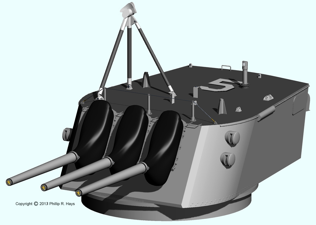

Next up is the triple 6"/47 turret. It is a bit more complex than the 5" mount.
The Cleveland class CLs had four of these, and the earlier Brooklyn class ships had five. There were a lot of variations from ship to ship, mainly in the presence or absence of ladders on the face of the turret and the size and configuration of the vent hoods on the back. Some ships had railings on top but the OK City had them on the sides. In port we tied off canvas awnings to these railings. Turrets on the main deck had hatches in the back plate as shown in the pictures below. Superelevated turrets had hatches in the bottom.
Near the end of WWII the Navy began removing the optical rangefinders from the #1 turrets on ships that went into shipyards. This was a weight saving measure. The #4 turrets on ALL Cleveland class ships never had these rangefinders, and this appears to be true of the #5 turrets on the Brooklyns also.
I have the blueprints for these turrets and this model is drawn to the dimensions in the blueprints. Some small details visible in photographs have been added. I do not have drawings for the 6"/47 gun - I have searched for years and haven't found them - so the barrel dimensions were guestimated from photos and ordnance flyers.
There were several modifications to the replenishment tripod on top of the turret. It could be rigged for operation from either port or starboard, but we normally replenished from the starboard side. The first two pictures show it lowered and the other pictures show it raised. The cable passed through the notch at the top of the tripod, then rubbed against the half-cylindrical bulges on the top sides of the turret before leading down and being fastened to the main deck on the side opposite the replenishment ship. We only took on ammunition at this forward replenishment station.
