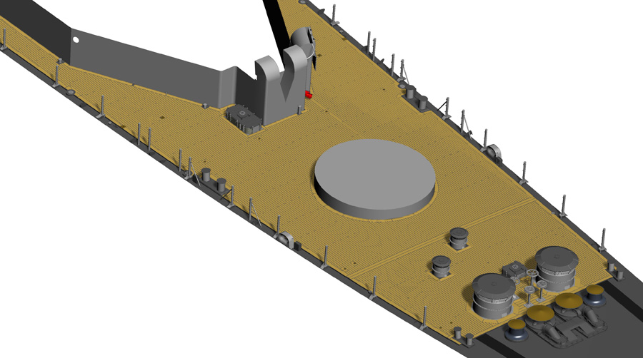

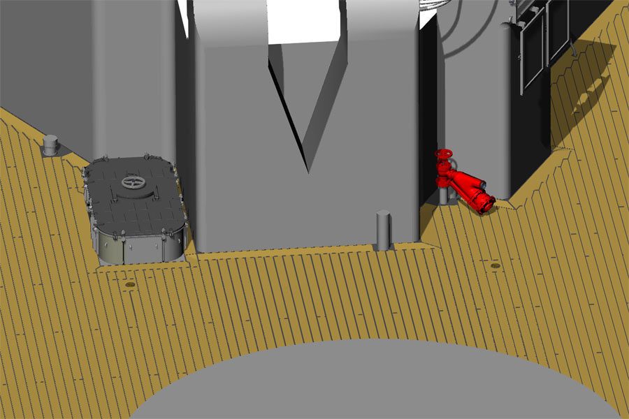

The wood deck is finished, all bazillion planks, margin boards and grout lines!
For most of the deck the pattern repeats every fourth plank, with the nominal plank length 16 feet (four frames). However, amidships the ship had a lot of modifications and the pattern is pretty scrambled. I used high resolution photos to determine where plank ends were positioned, but that didn't give me the entire pattern. This is my best guess.
There are a few finishing touches to do before I copy the deck from the working file and paste it into the full hull file. Then the hull will be almost finished (I need to add the trash chute at the stern).
Then the entire CAD model will be almost finished. I need to rework the AN/SPS-30 on the after radar tower, and maybe a few other small details. Then all I need to do is paste together the hull, forward, midships and after superstructures and it will be done!!!!
I don't know if I can actually do that. The resulting file will be about 1 gigabyte and will have about 2.7 million drawing entities and about 21 million points (these are the sums of the separate files, and there is a bit of overlap so the final numbers should be a bit smaller). I don't know if anyone has ever constructed a file that large with DesignCAD. There may be some variable(s) in the program left over from 32 bit days that just can't hold numbers that large.
Wish me luck!

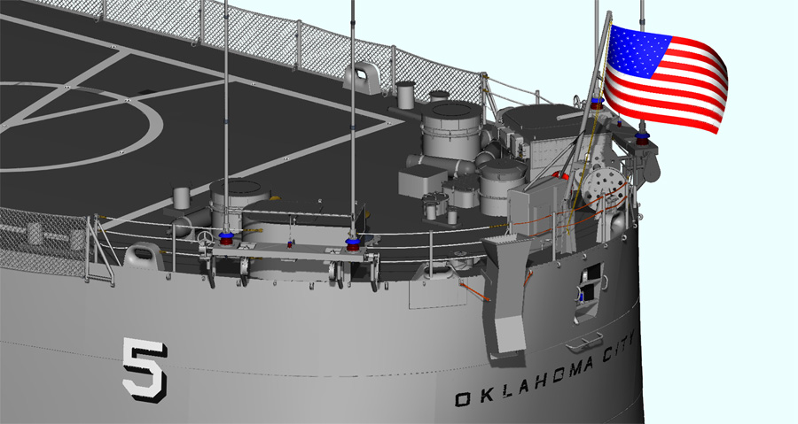

Here are some pictures of the stern with the trash chute.
This square trash chute was on the ship in 1960, probably there at commissioning because the earliest photos show it. However, it appears to have been crushed sometime after February 1971, and was replaced by January 1972 with a trash chute made of welded 55 gallon barrels with the ends cut out. But the square trash chute must have been repaired because it was back on the stern in 1974. It was still there at decommissioning in 1979.
I don't see anything like it in the WWII photos.
The hull is complete. Well, maybe it will never be complete. I can think of a few details that could be added, but it is finished for now.

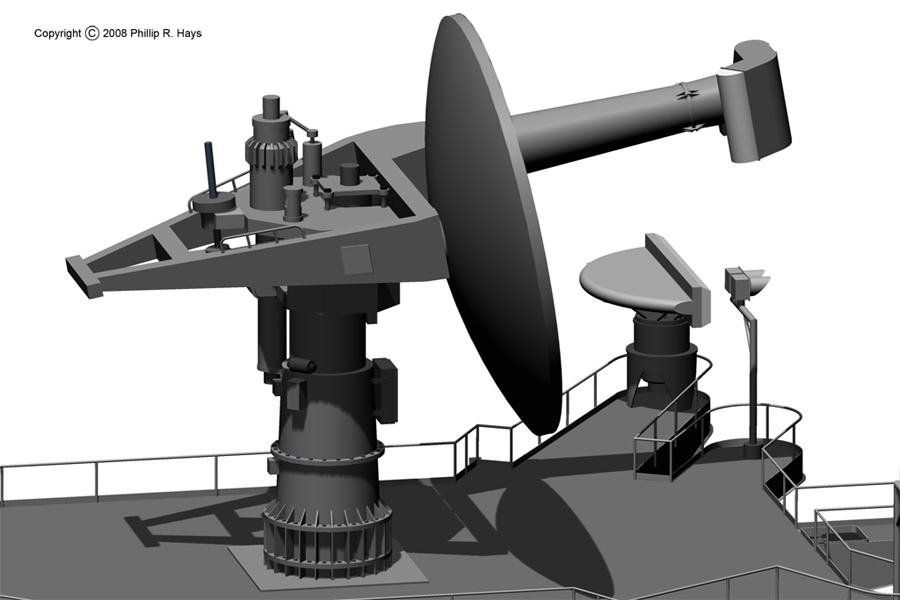

I have started on a new model of the AS-1167/SPS-30 antenna for the AN/SPS-30 radar.
Back in 2008 I had only a few distant fuzzy photos to work from and the CAD model was just a place holder until I had better information to work from.
File comment: The 2008 model.
I thought the base tower was a two part truncated cone with a cylinder on top of that. In fact the "joint" between the two parts of the cone was a foot rail, and the top was not a cylinder.
The antenna was mounted on two spacer rings at the bottom to raise it high enough that the parabolic reflector dish or the feed horn would not strike the deck at extremes of roll, pitch and elevation. The base tower actually isn't a truncated cone. It is circular at the bottom and more or less square at the top with rounded corners. The foot rail aided working on the mechanism.

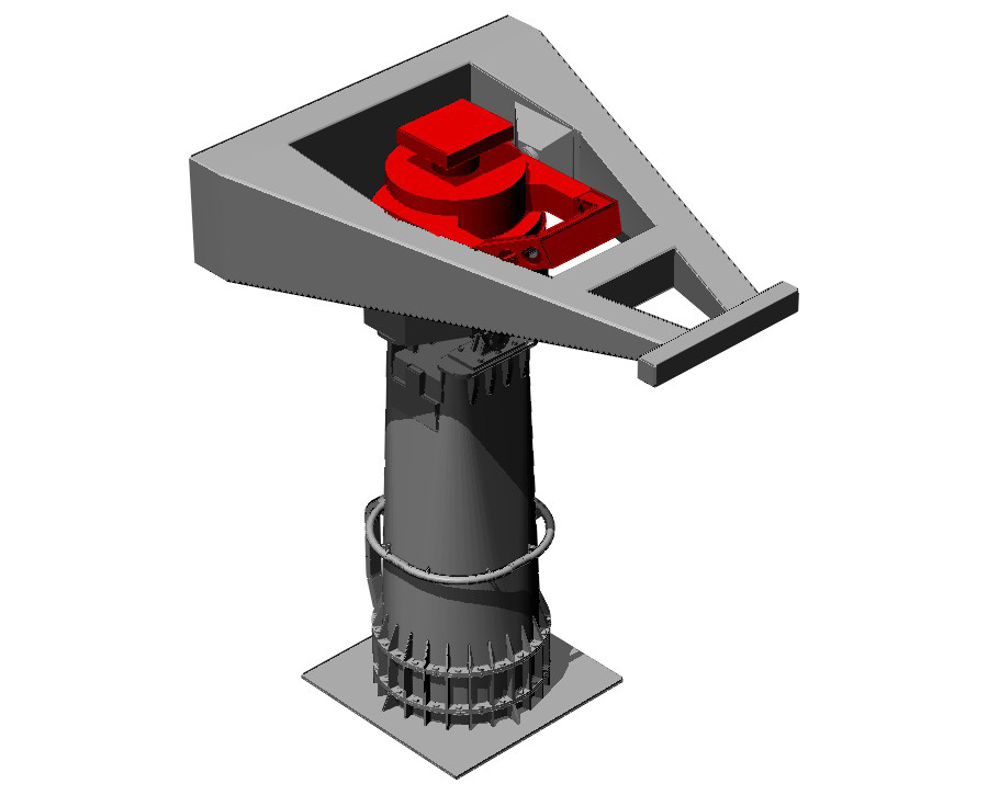

File comment: The new base.
The base supported a roll platform that pivoted along the fore-aft axis on bearings on the base tower. This was driven by two motors (not modeled yet) that corrected for the ship's roll to keep the antenna horizontal port/starboard. Above this was the pitch platform that pivoted on the port/starboard axis on bearings supported by the roll platform. Again, two motors (not shown) corrected for the ship's pitch to keep the antenna horizontal fore/aft.
The red part is the rotation platform that supported the elevation platform and rotated 360 degrees around the vertical axis on bearings on the pitch platform. It was driven by a large motor (not shown) mounted on the rotation platform. It is red because I have not finished with the basic shapes.
The rectangular box at the top rotated with the rotation platform. It contained electrical slip rings for power and signals to the elevation platform. It also contained the rotating wave guide joint for the radar signals to and from the feed horn.
