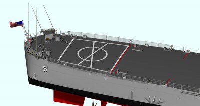

Here are some pictures of the completed hull!! Well, almost - I still need to add the trash chute at the stern.
The hull shell took quite a while - it is built up of individual plates just as shown in the Cleveland blueprints. It has about 480 plates in 15 strakes, with each plate shaped and curved to fit the hull frames.
The lifeline stanchions were another custom fit project. Each is mounted on a frame that spans a 15" waterway at the side of the main deck. The hull plating extends above deck edge at the waterway, and the height varies along the length of the ship, so each stanchion base is adapted to the height and angle of the shell plating. No two are alike, but fortunately most of the port side were the mirror image of the starboard stanchions.
The fold-down life nets around the flight deck were another tedious job. Again the two sides are mirror images so I only had to do one side and then duplicate and mirror it.
And then there is the wooden deck, with each plank and grout line done individually. Only a small part of the two sides were mirror images.
505,959 drawing entities with 4,159,420 points.

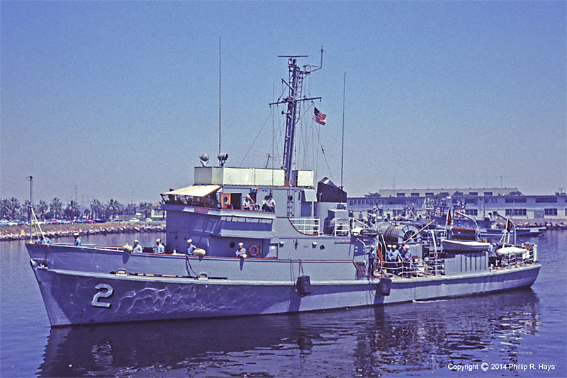

The reason I am thinking about the USS Cape MSI-2 is that it was my first ship. I was Engineering Officer, Supply Officer, and 25 other official duties - right out of Officer Candidate School. Three officers (the CO was a brand new Lieutenant and the XO was a surfer from SOCAL and I was George) and 19 enlisted men. Home ported in Long Beach, California.
The Cape and her sister ship the USS Cove MSI-1 were perhaps the most useless "ships" the Navy ever built. And even though they were only 112 feet long and would normally be called a "boat" we had a letter from the Secretary of the Navy designating them as "United States Ships."
Serving on them was quite an experience! Did you ever see the TV series "McHale's Navy?" It was just like that. They were really too small to be an effective mine sweeper, so during fleet operations we were told to stay out of the way until operations were complete. Sometimes we would just patrol the operations area to keep out sight seers. We were bolted to the pier most of the time, and most of the crew lived ashore. We occasionally went out on "training" exercises around Catalina Island and fished, sometimes going dead in the water for a BBQ on the fantail. The Cape was the flagship of the mine squadron, for reasons that are totally beyond me!
Both MSIs were determined to be worthless and decommissioned in 1969, about six months after I went aboard. From there I went to the OK City, and that was quite a change!
So, you see, I think this ship is also unique in it's own way and needs to be preserved in CAD for posterity.

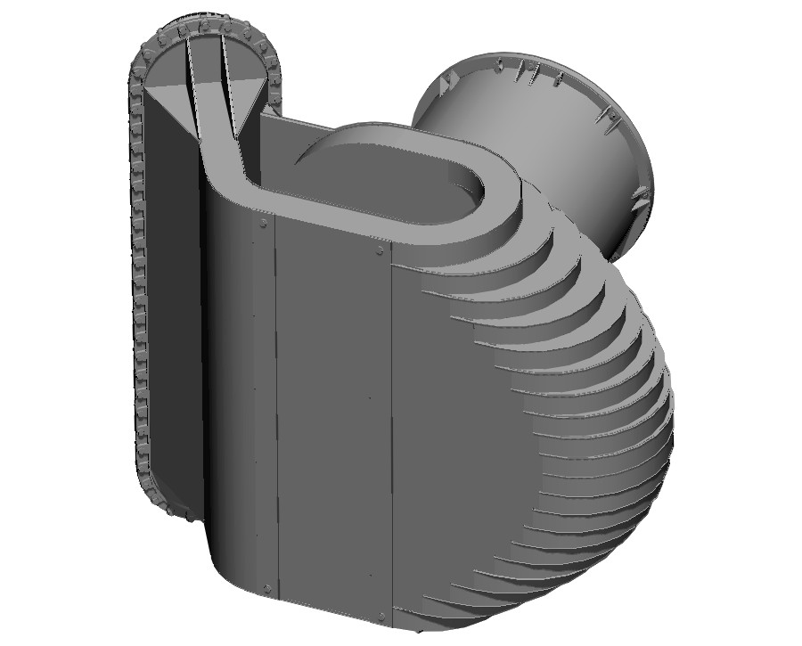

Here are some pictures of the stern with the trash chute.
This square trash chute was on the ship in 1960, probably there at commissioning because the earliest photos show it. However, it appears to have been crushed sometime after February 1971, and was replaced by January 1972 with a trash chute made of welded 55 gallon barrels with the ends cut out. But the square trash chute must have been repaired because it was back on the stern in 1974. It was still there at decommissioning in 1979.
I don't see anything like it in the WWII photos.
The hull is complete. Well, maybe it will never be complete. I can think of a few details that could be added, but it is finished for now.

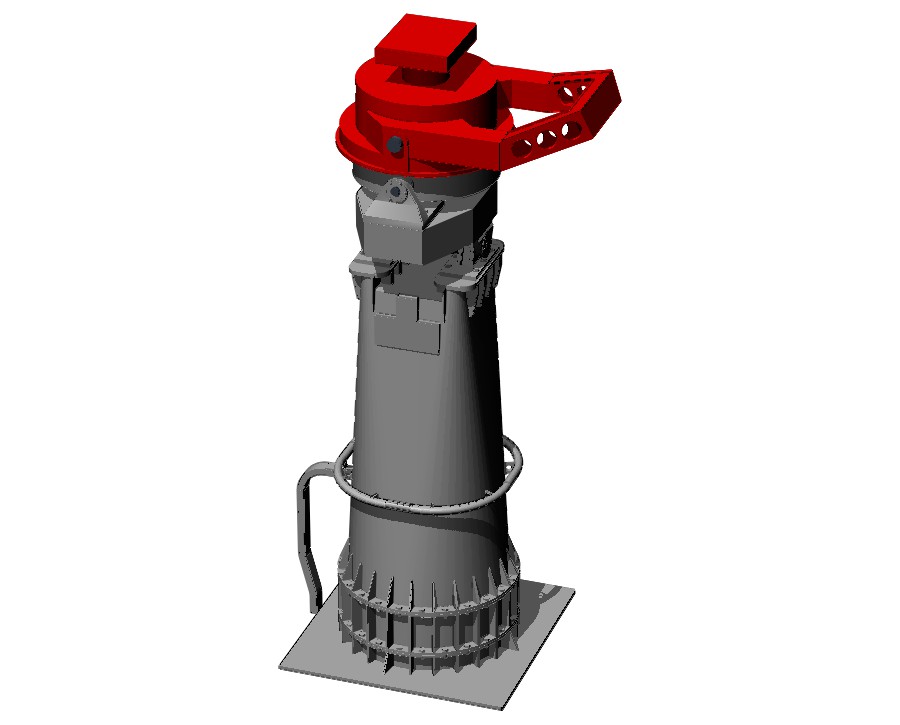

The base supported a roll platform that pivoted along the fore-aft axis on bearings on the base tower. This was driven by two motors (not modeled yet) that corrected for the ship's roll to keep the antenna horizontal port/starboard. Above this was the pitch platform that pivoted on the port/starboard axis on bearings supported by the roll platform. Again, two motors (not shown) corrected for the ship's pitch to keep the antenna horizontal fore/aft.
The red part is the rotation platform that supported the elevation platform and rotated 360 degrees around the vertical axis on bearings on the pitch platform. It was driven by a large motor (not shown) mounted on the rotation platform. It is red because I have not finished with the basic shapes.
The rectangular box at the top rotated with the rotation platform. It contained electrical slip rings for power and signals to the elevation platform. It also contained the rotating wave guide joint for the radar signals to and from the feed horn.

The elevation platform was a large box structure that pivoted on bearings in the rotation platform. A motor (not shown) on the back end of the rotation platform (where the holes are) pulled the cross member up and down to change the elevation of the antenna. The long feed horn and parabolic dish (not shown) attached to the front of the elevation platform.
File comment: The rotation platform and elevation platform.

In heavy seas the ship rolled +/- 30 degrees and pitched +/- 5 degrees, and the radar antennas were at the top of tall towers where they gyrated wildly in 100+ knot winds, rain, hail, snow, ice and salt spray.
When operating the SPS-30 and SPS-43 radars with their huge antennas it was always in the back of my mind what enormous stresses were being forced upon the structures when you changed rotation speeds or just gave that joystick a little twitch.
