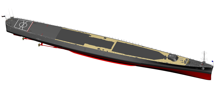

Here are some pictures of the completed hull!! Well, almost - I still need to add the trash chute at the stern.
The hull shell took quite a while - it is built up of individual plates just as shown in the Cleveland blueprints. It has about 480 plates in 15 strakes, with each plate shaped and curved to fit the hull frames.
The lifeline stanchions were another custom fit project. Each is mounted on a frame that spans a 15" waterway at the side of the main deck. The hull plating extends above deck edge at the waterway, and the height varies along the length of the ship, so each stanchion base is adapted to the height and angle of the shell plating. No two are alike, but fortunately most of the port side were the mirror image of the starboard stanchions.
The fold-down life nets around the flight deck were another tedious job. Again the two sides are mirror images so I only had to do one side and then duplicate and mirror it.
And then there is the wooden deck, with each plank and grout line done individually. Only a small part of the two sides were mirror images.
505,959 drawing entities with 4,159,420 points.
