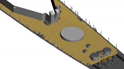

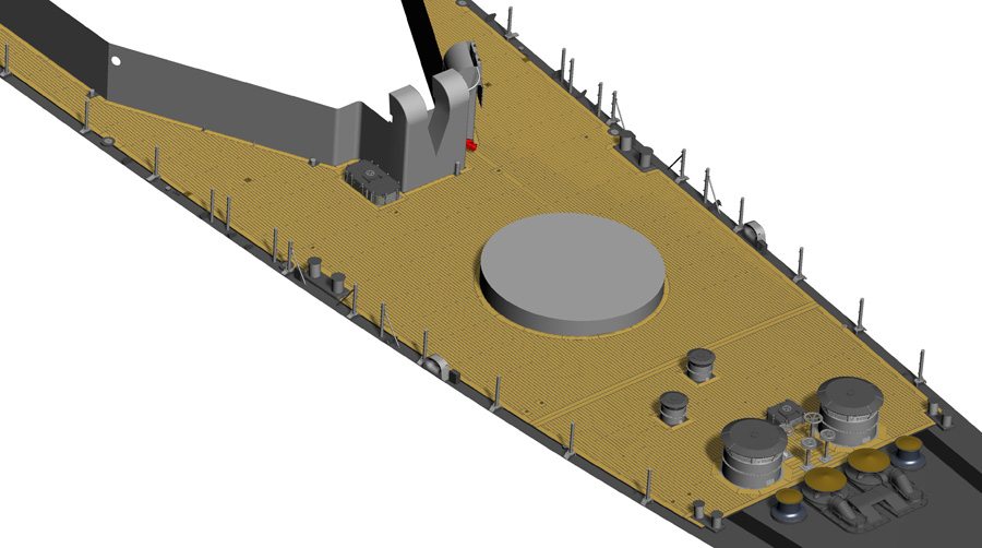

I have been very busy with other non-modeling projects but I have finally gotten back to work on the wood deck. It is tedious work.
I have been scrutinizing photographs to determine how the planks were laid. I know from the blueprints that the boards were no longer than 18 feet, and it looks like they were actually cut to increments of 4 feet, coinciding with the frame spacing on the ship.
However, this forward extension appears to have been made with some scraps, so the plank lengths are somewhat random, and not always laid down in a regular pattern. Most of the rest of the deck does appear to be in a pretty regular pattern except at midships where the original two level boat davits were replaced with a single davit set on the starboard, and no davits on the port. It looks like the planking in these places has a lot of patches.
The forward part shown here was not on the original Clevelands. It was added to some of the CLGs, but no two are alike.

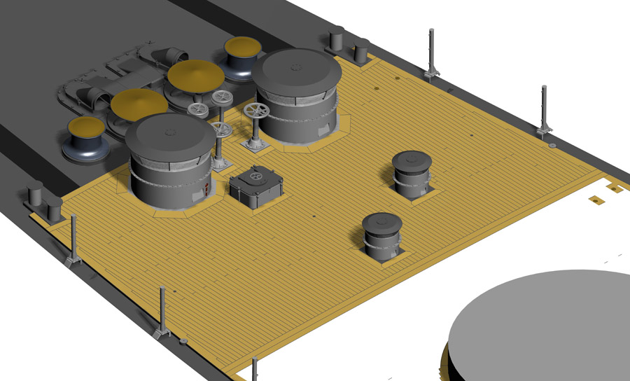

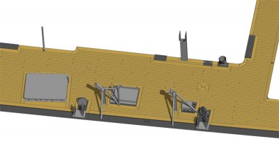

The wood deck is finished, all bazillion planks, margin boards and grout lines!
For most of the deck the pattern repeats every fourth plank, with the nominal plank length 16 feet (four frames). However, amidships the ship had a lot of modifications and the pattern is pretty scrambled. I used high resolution photos to determine where plank ends were positioned, but that didn't give me the entire pattern. This is my best guess.
There are a few finishing touches to do before I copy the deck from the working file and paste it into the full hull file. Then the hull will be almost finished (I need to add the trash chute at the stern).
Then the entire CAD model will be almost finished. I need to rework the AN/SPS-30 on the after radar tower, and maybe a few other small details. Then all I need to do is paste together the hull, forward, midships and after superstructures and it will be done!!!!
I don't know if I can actually do that. The resulting file will be about 1 gigabyte and will have about 2.7 million drawing entities and about 21 million points (these are the sums of the separate files, and there is a bit of overlap so the final numbers should be a bit smaller). I don't know if anyone has ever constructed a file that large with DesignCAD. There may be some variable(s) in the program left over from 32 bit days that just can't hold numbers that large.
Wish me luck!

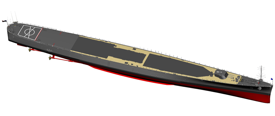

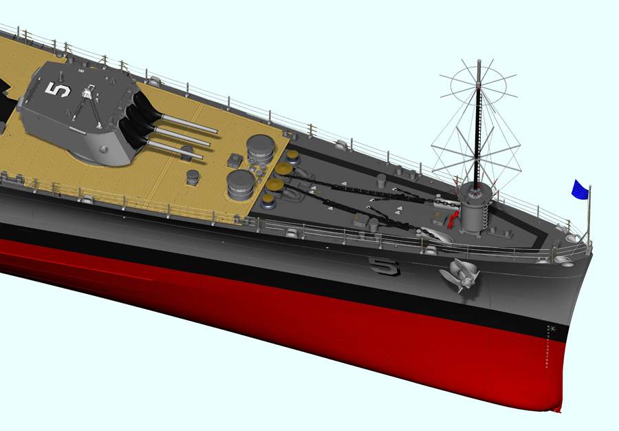

Here are some pictures of the completed hull!! Well, almost - I still need to add the trash chute at the stern.
The hull shell took quite a while - it is built up of individual plates just as shown in the Cleveland blueprints. It has about 480 plates in 15 strakes, with each plate shaped and curved to fit the hull frames.
The lifeline stanchions were another custom fit project. Each is mounted on a frame that spans a 15" waterway at the side of the main deck. The hull plating extends above deck edge at the waterway, and the height varies along the length of the ship, so each stanchion base is adapted to the height and angle of the shell plating. No two are alike, but fortunately most of the port side were the mirror image of the starboard stanchions.
The fold-down life nets around the flight deck were another tedious job. Again the two sides are mirror images so I only had to do one side and then duplicate and mirror it.
And then there is the wooden deck, with each plank and grout line done individually. Only a small part of the two sides were mirror images.
505,959 drawing entities with 4,159,420 points.

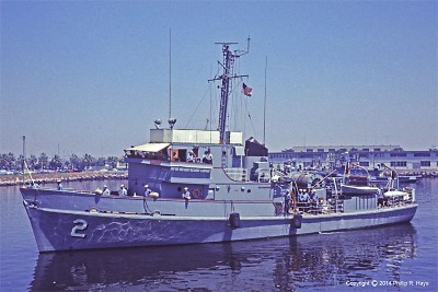

Colosseum,
The reason I am thinking about the USS Cape MSI-2 is that it was my first ship. I was Engineering Officer, Supply Officer, and 25 other official duties - right out of Officer Candidate School. Three officers (the CO was a brand new Lieutenant and the XO was a surfer from SOCAL and I was George) and 19 enlisted men. Home ported in Long Beach, California.
The Cape and her sister ship the USS Cove MSI-1 were perhaps the most useless "ships" the Navy ever built. And even though they were only 112 feet long and would normally be called a "boat" we had a letter from the Secretary of the Navy designating them as "United States Ships."
Serving on them was quite an experience! Did you ever see the TV series "McHale's Navy?" It was just like that. They were really too small to be an effective mine sweeper, so during fleet operations we were told to stay out of the way until operations were complete. Sometimes we would just patrol the operations area to keep out sight seers. We were bolted to the pier most of the time, and most of the crew lived ashore. We occasionally went out on "training" exercises around Catalina Island and fished, sometimes going dead in the water for a BBQ on the fantail. The Cape was the flagship of the mine squadron, for reasons that are totally beyond me!
Both MSIs were determined to be worthless and decommissioned in 1969, about six months after I went aboard. From there I went to the OK City, and that was quite a change!
So, you see, I think this ship is also unique in it's own way and needs to be preserved in CAD for posterity.

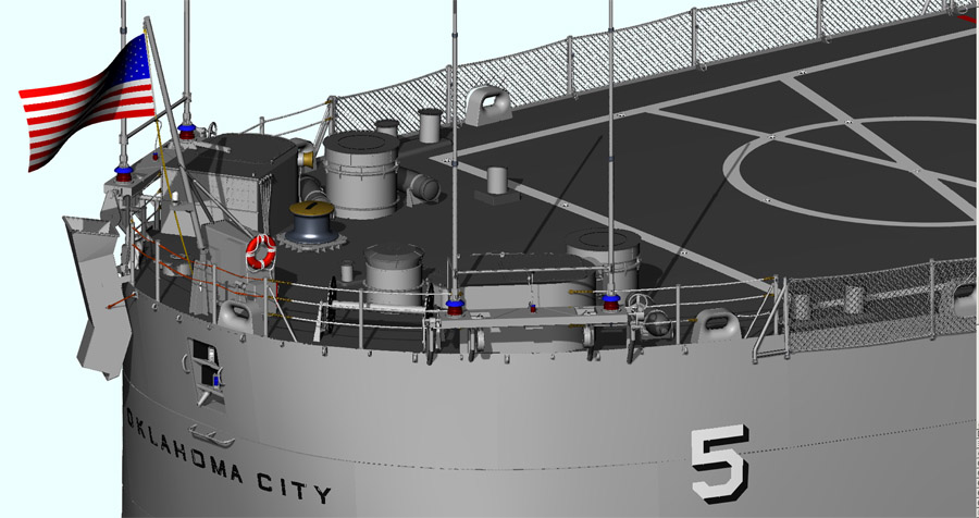

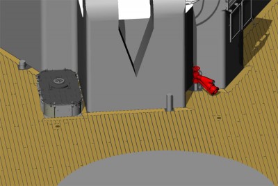

Here are some pictures of the stern with the trash chute.
This square trash chute was on the ship in 1960, probably there at commissioning because the earliest photos show it. However, it appears to have been crushed sometime after February 1971, and was replaced by January 1972 with a trash chute made of welded 55 gallon barrels with the ends cut out. But the square trash chute must have been repaired because it was back on the stern in 1974. It was still there at decommissioning in 1979.
I don't see anything like it in the WWII photos.
The hull is complete. Well, maybe it will never be complete. I can think of a few details that could be added, but it is finished for now.

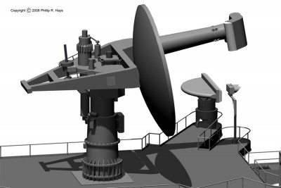

I have started on a new model of the AS-1167/SPS-30 antenna for the AN/SPS-30 radar.
Back in 2008 I had only a few distant fuzzy photos to work from and the CAD model was just a place holder until I had better information to work from.
The 2008 model.
The 2008 model.

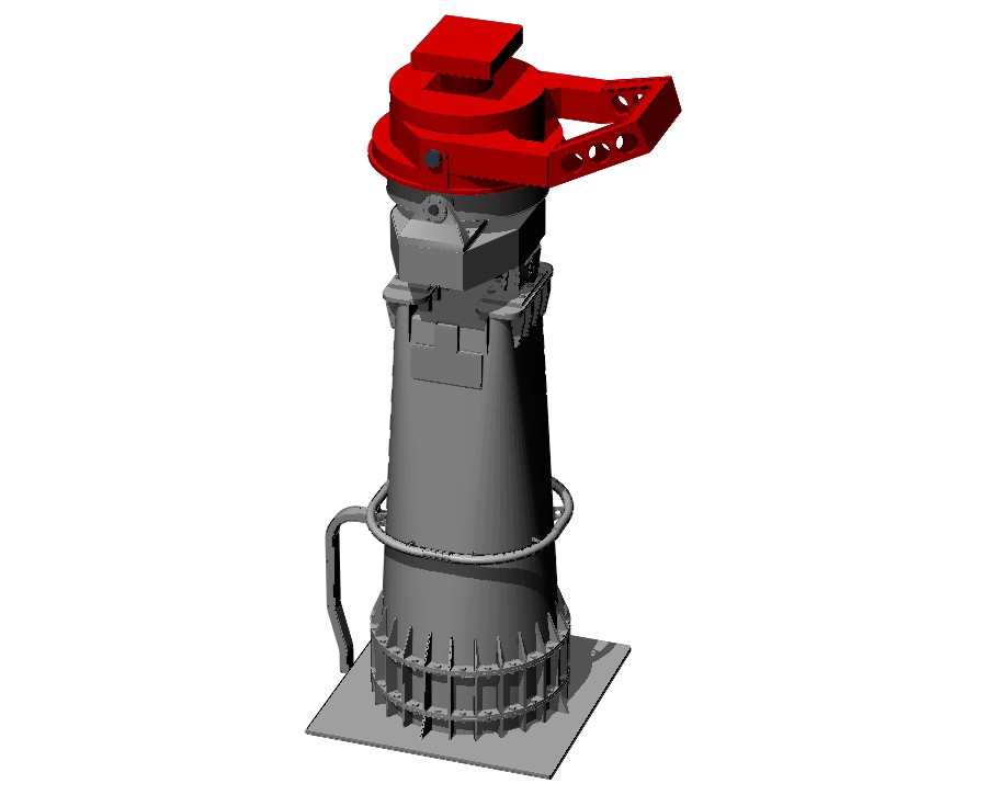

I thought the base tower was a two part truncated cone with a cylinder on top of that. In fact the "joint" between the two parts of the cone was a foot rail, and the top was not a cylinder.
The antenna was mounted on two spacer rings at the bottom to raise it high enough that the parabolic reflector dish or the feed horn would not strike the deck at extremes of roll, pitch and elevation. The base tower actually isn't a truncated cone. It is circular at the bottom and more or less square at the top with rounded corners. The foot rail aided working on the mechanism.
The new base.
The new base.

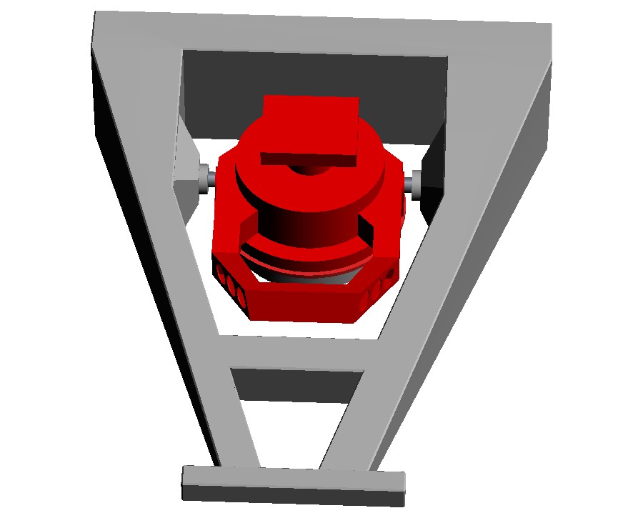

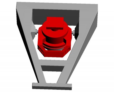

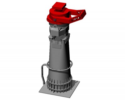

The base supported a roll platform that pivoted along the fore-aft axis on bearings on the base tower. This was driven by two motors (not modeled yet) that corrected for the ship's roll to keep the antenna horizontal port/starboard. Above this was the pitch platform that pivoted on the port/starboard axis on bearings supported by the roll platform. Again, two motors (not shown) corrected for the ship's pitch to keep the antenna horizontal fore/aft.
The red part is the rotation platform that supported the elevation platform and rotated 360 degrees around the vertical axis on bearings on the pitch platform. It was driven by a large motor (not shown) mounted on the rotation platform. It is red because I have not finished with the basic shapes.
The rectangular box at the top rotated with the rotation platform. It contained electrical slip rings for power and signals to the elevation platform. It also contained the rotating wave guide joint for the radar signals to and from the feed horn.
The elevation platform.
The elevation platform was a large box structure that pivoted on bearings in the rotation platform. A motor (not shown) on the back end of the rotation platform (where the holes are) pulled the cross member up and down to change the elevation of the antenna. The long feed horn and parabolic dish (not shown) attached to the front of the elevation platform.
The rotation platform and elevation platform.
These are just the basic support shapes. There are a lot of details to add. Fortunately, in the past 10 years I have discovered detailed photos and some antenna drawings. I have received quite a few very close up photos of the SPS-30 on the USS Little Rock CG-5 museum ship by guys who help maintain the ship.

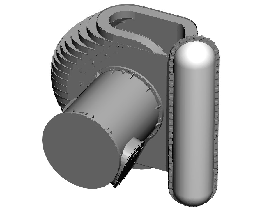

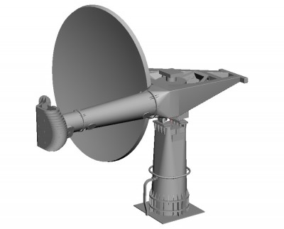

I haven't had a lot of time to work on the AS-1167/SPS-30 antenna, but I did get a bit more done.
I have added the support arm and scanner head, and I am working on the reflector dish.

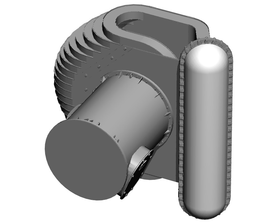

The dish was a surprise. Originally I thought it was an ordinary circular parabolic reflector. But I have obtained drawings of the SPS-30 and the dish was actually elliptical, with the major axis vertical! That posed some interesting problems for modelling because the edge of the dish was curved both in the plane of the dish and perpendicular to it!

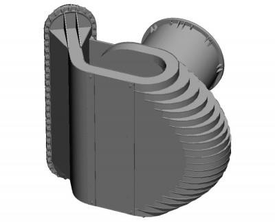

The "organ pipe" scanner head is interesting. To get rapid vertical height-finding scanning it has a rotary waveguide switch inside the cylindrical part that directs RF energy into one of twenty equal-length waveguides arranged circularly around the end of the cylinder. The waveguides then fan out into a parallel bunch that wraps around 180 degrees and then bends around to the feed horn. A RF transparent cover over the end of the feed horn allows the entire waveguide assembly to be pressurized with dry nitrogen to prevent internal arcing with the 2500 kW peak RF energy.
Because the feed horn ends are stacked vertically, each beam strikes the parabolic reflector at a different spot and is projected outward at a different narrow (1.2 degree) vertical angle. The vertical scanning rate was controlled by the rotating waveguide switch RPM from 240 to 2400 per minute. Pretty clever!
The entire reflector assembly could be tilted from 6 to 30 degrees above horizontal for coarse elevation control, and then the multiple waveguides provided fine elevation sweeping. The antenna could rotate around the vertical axis in a full circle at 1 to 10 RPM.

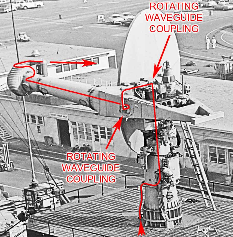

Post by DrPR »
Michael,
The SPS-30 transmitters were in the superstructure below the radar tower where the antenna was mounted. See this link for images of the after superstructure and radar tower:
https://www.okieboat.com/CAD%20superstructure.html
The S band waveguide came out of the top of the superstructure and up to below the tower deck. Then it passed through the deck just in front of the antenna base. You can see it in the attached image (red line), where it comes up, curves and enters the base just below the foot ring.
From there it rose up the vertical center axis of the base to a rotating waveguide coupling at the very top of the drive platform - the rectangular box contained the slip rings for electrical signals and power and the waveguide coupling. The elevation platform, dish reflector, support arm and scanning head rotated around the vertical axis.
The microwave signals passed through the rotating waveguide coupling and followed a waveguide to the left (looking toward the scanner head) side of the elevation platform where the waveguide curved downward to another rotating waveguide coupling on the horizontal axis of rotation for the elevation platform.
The signals passed through this rotating coupling and into a waveguide inside the support arm leading to the rotating waveguide switch in the scanner head. I have shown the path into the top of the 20 parallel waveguides coming from the rotating switch in the scanner head.
All of this waveguide plumbing was pressurized with dry nitrogen. The SPG-49 tracking radars were also pressurized (I am not sure about the SPS-10 and SPS-43 radars) so you have to figure there were leaks. If you look at my CAD model you will see a lot of green nitrogen gas bottles attached to the superstructure (there were even more in internal compartments).
