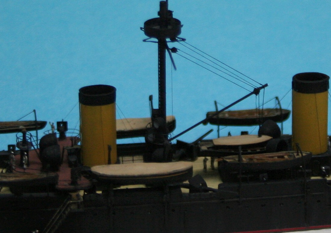

Thereafter the flatcoating was uneventful...( phew!) as usual I was using the Galeria varnish I obtained a very flat even and dead smooth surface.
The rigging is quite challenging-- funnel stays in particular....
Boat falls have been made. as well as the main boom rigging
The ship will now be at anchor after all !! :big_grin: :cool_2:
a naval review in 1904 ( fortunately I found a photo to verify this scene...! :thumbs_up_1:
....===> mainly so that I can show her with Big Ensigns on all three masts, as well as on the stern,(!!) with the red white and blue ensign on the fwd jack-staff.

back from the ( rigging ) wilderness....! :wave_1:
she is complete at last!- there was a lot of very fine rigging to do on some very very skinny masts...
( :mad_1: :Mad_6: :Mad_5: :mad_2: :censored_2: :lol_3: )
- full photo coverage will be in the gallery in due course.
meanwhile..... here are a few taster shots....
onwards to the new project :thumbs_up_1:
Thank you all for following this build--a link to the gallery will be posted when it appears there ....
Jim Baumann

There are some limited aspects I might be able to replicate on my own models, but on the whole this is modeling on a whole other level. The flawless and near invisible rigging on these skinny masts simply let my jaw drop, into the depression on my desk created by repeated drops over years of wtinessing your builds, Jim.
Kind regards
Frank

Jim,
Are the flags printed paper? How did you get them to flutter so naturally? I tend to use white glue + paper but it tends to appear overscale in 1/700.
- Chris
