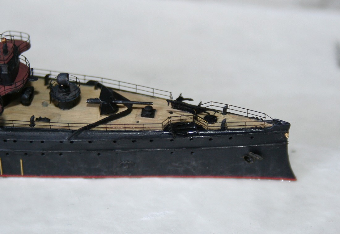

Created the anchor beds by outlining with the railing
Once furnished with anchors and handling crane it all looked quite pleasing

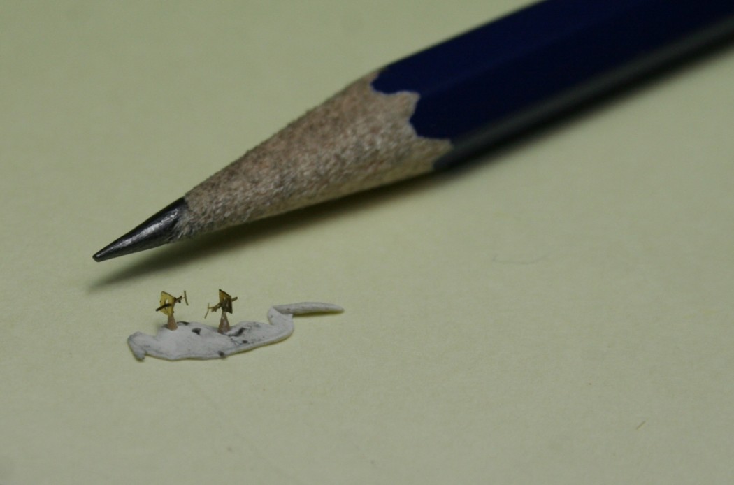

Onwards to the 6 x Hotchkiss guns
The bases for these were made using a sharpened cocktail stick tip dipped in CA cut to size
Added to that was a cut down and modified old over-scale PE Oerlikon from an early 1990's GMM set
Added small shield and an aiming brace of cut about PE handrail

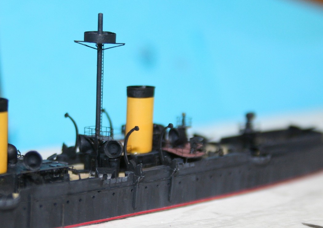

After the tedium of making wire davits and ships boats ...the fun of erecting masts could commence !
Zhemchug carried outrageously tall masts--three of them.
I have devised a method of enuring the masts all set perpendicular whilst the slow setting epoxy and CA are setting
Simply suspend the ship upside down--the masts dangle nicely... :heh: easier than trying to keep them in position with the ship upright!!-- let gravity be your friend! :thumbs_up_1:

back from the ( rigging ) wilderness....! :wave_1:
she is complete at last!- there was a lot of very fine rigging to do on some very very skinny masts...
( :mad_1: :Mad_6: :Mad_5: :mad_2: :censored_2: :lol_3: )
- full photo coverage will be in the gallery in due course.
meanwhile..... here are a few taster shots....
onwards to the new project :thumbs_up_1:
Thank you all for following this build--a link to the gallery will be posted when it appears there ....
Jim Baumann
