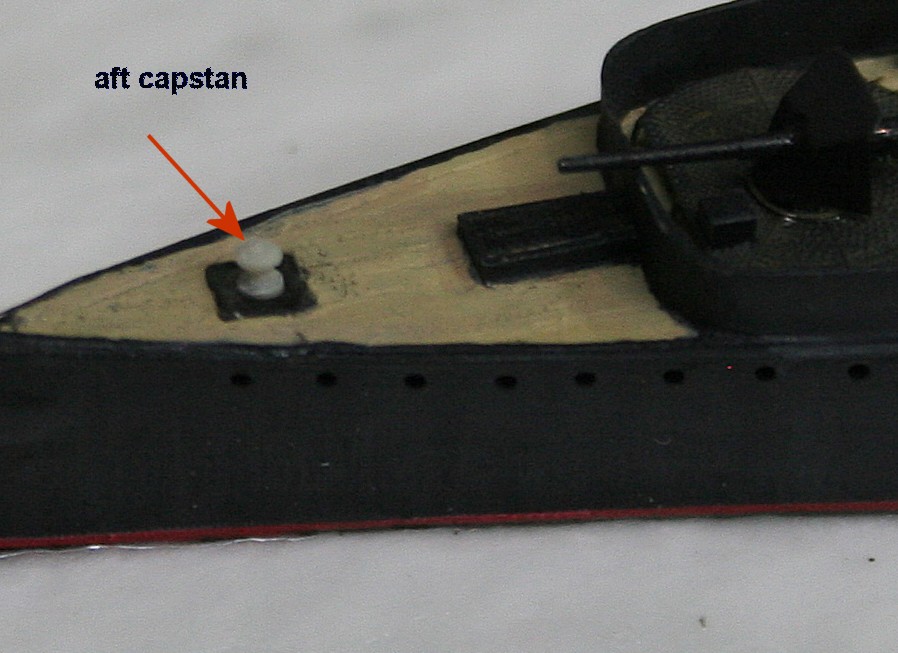

The capstans on the foredeck and the aft deck were turned from resin-mast scrap in a mini-drill.
Resin turns beautifully --and unlike plastic is a ""clean" material to turn--not un-akin to metal!

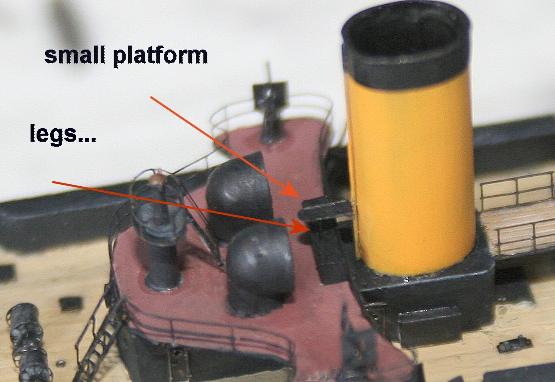

spent crazy amount of time making a small platform ( using a PE door )
supported on 2 small legs... :scratch: :doh_1:

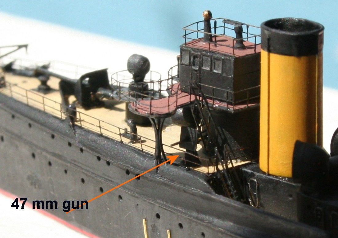

....spent even more time making 6 x 47 mm guns-- the conical bases were made from cocktail stick tipd immersed in CA. topped with a small styrene sliver-- furnished with shields from a WEM Askold PE fret and a copper wire barrel.
The kit supplied items were too tall and clunky for my liking
