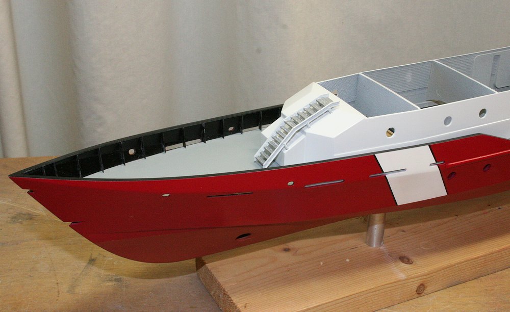

A busy weekend with the airbrush. Lots of little details, as well as big jobs like the hull. I jump around a bit... painted and assembled the aft ladder for example.
File comment: Hull mostly painted
File comment: Aft ladder, all 3DP
File comment: 1:1 ladder... ok, a few liberties taken... my railings are a heavy 0.75mm, close to the limit for this printing technology and modeling feasibility.

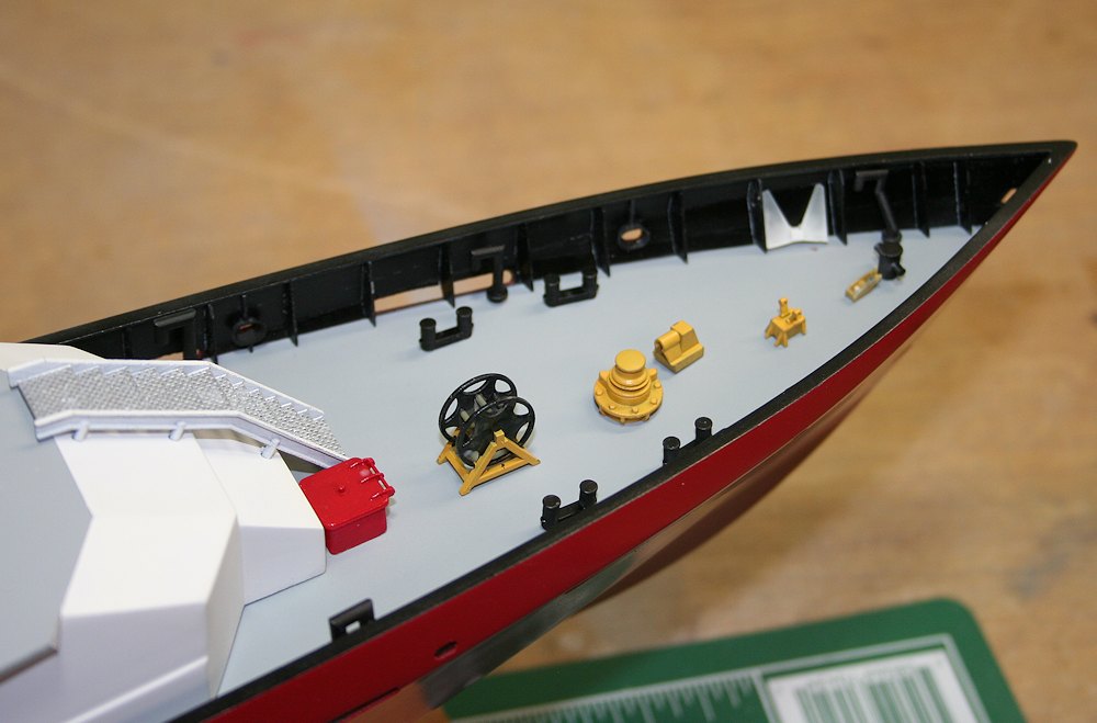

The forward bulwark braces (20 per side) are ALL different, to fit inside the bulwark with its changing form. Of course you COULD design these to be printed with the hull, but then it would be a nightmare to sand between them, not to mention painting, especially where they meet the deck. So they're all loose, and now it's time to pay the piper...
I designed them 0.5mm "into" the bulwark wall, and then subtracted them from the hull, leaving perfectly placed grooves for placement. These are all scraped out after painting, and the braces are prepainted and ready for gluing in place. Well, at least I've started.
File comment: Scraping the grooves out... 0.5mm wide.
File comment: It's a start.

Working on the foredeck, it's like hanging ornaments on a tree...
You can see some of the crazy bent vent pipes along the bulwarks... easy in 3D, they'd be a bear to hand build!
File comment: 1:1 version
File comment: ALL fittings should be pegged for mounting. Sometimes I remember to include them in the 3DP, sometimes I add them, like here with 0.030" rod.
File comment: Most of the gear loosely in place. Needs a lot of touch up paint still. I like how the detail on the windlass came out.

Another example of the problem of surface finish. SLS (selective laser sintering) fuses dry nylon powder together to make the part. It's more affordable than most multijet processes, but it make porous parts with a larger step dimension. This means lots of filling and sanding, which again means that little surface detail should be included to allow for the sanding. It's also helpful to use a heavy primer-filler for the first coat or two.
My pilot house and pilot house roof are both SLS. The house is nearly done and is looking good, while the roof has only had the first coat of primer filler, and could use another before I go to regular "finish primer"... see the steps in the shallow angles on the roof.
