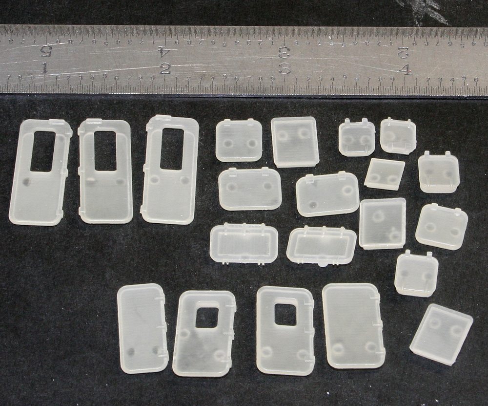

PostPosted: Sun Jun 09, 2013 3:02 pm
Joined: Fri Jan 21, 2005 8:24 pm
Posts: 418
Location: Michigan
more
File comment: Doors & hatch covers

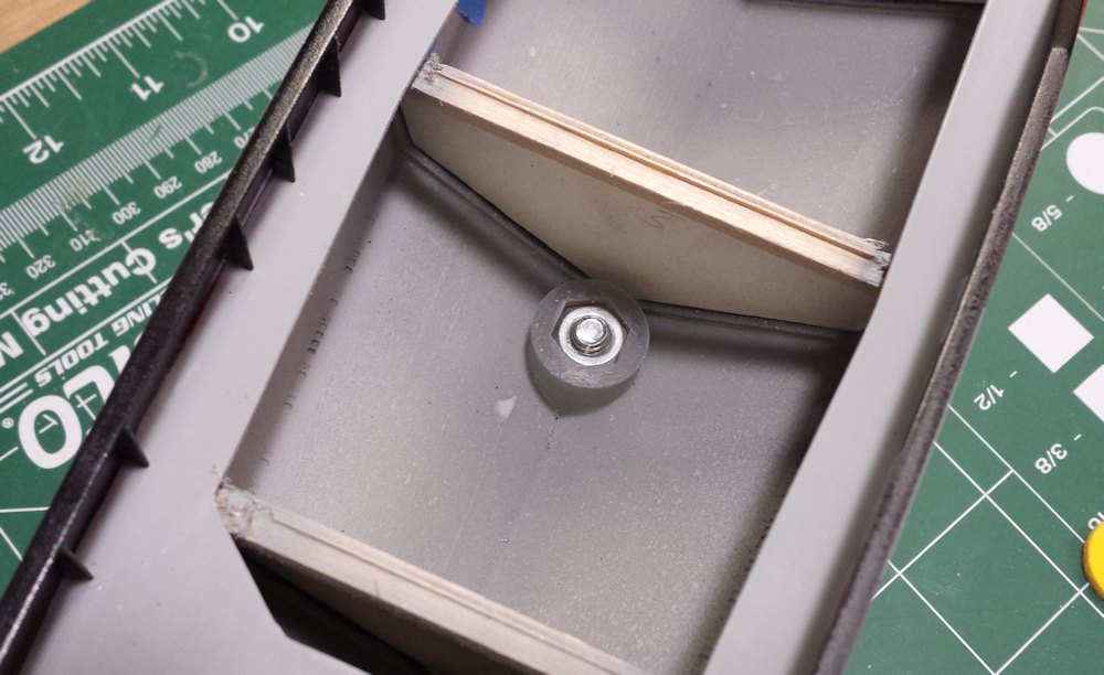

If you're going to print a hull, you can include all sorts of features... ledge for the deck, ribs for placing bulkheads, etc.
I included nice heavy bosses for the pedestal mounting.
> Inside, a cut-out locates the 1/4"-20 nuts; a simple cap is glued on to trap the nut.
> Under the keel, cut-outs provide sockets for the pedestals themselves. These are flat-bottomed, and set at the same height, so the pedestals are simple flat topped cylinders of the same length, and they mount the hull perfectly square to the base... no carving the pedestals to fit the hull!
And being so solid, I have no fears about the mounting screws being snugged up over the years...
File comment: Nut in socket
File comment: Cap to trap the nut
File comment: Socket underneath perfectly matches the pedestal.

Working on the foredeck, it's like hanging ornaments on a tree...
You can see some of the crazy bent vent pipes along the bulwarks... easy in 3D, they'd be a bear to hand build!
File comment: 1:1 version

Another example of the problem of surface finish. SLS (selective laser sintering) fuses dry nylon powder together to make the part. It's more affordable than most multijet processes, but it make porous parts with a larger step dimension. This means lots of filling and sanding, which again means that little surface detail should be included to allow for the sanding. It's also helpful to use a heavy primer-filler for the first coat or two.
My pilot house and pilot house roof are both SLS. The house is nearly done and is looking good, while the roof has only had the first coat of primer filler, and could use another before I go to regular "finish primer"... see the steps in the shallow angles on the roof.
