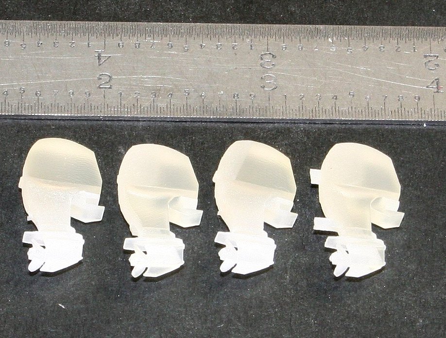

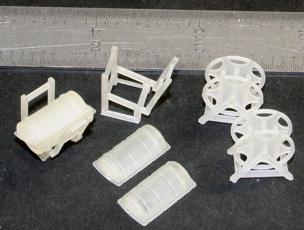

File comment: Reels & liferaft racks

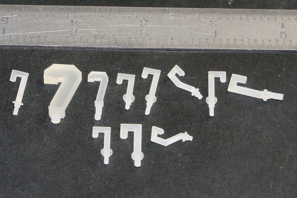

File comment: Crane parts

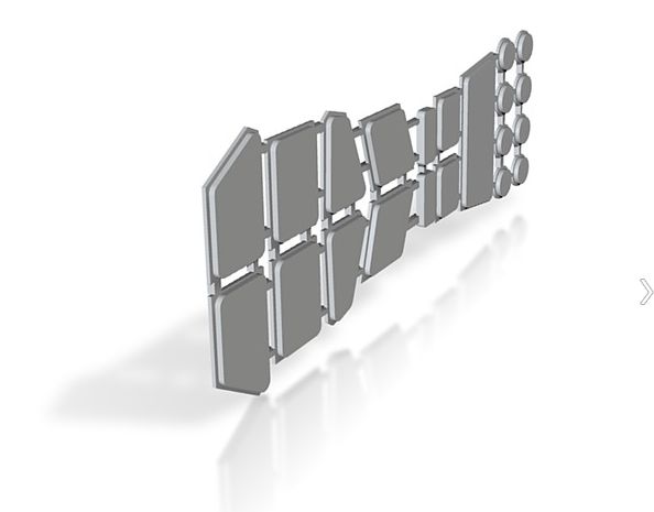

And here's what's coming:
File comment: Miscellaneous things that stick out here and there
File comment: Pilot house glazing (clear)

Working on the foredeck, it's like hanging ornaments on a tree...
You can see some of the crazy bent vent pipes along the bulwarks... easy in 3D, they'd be a bear to hand build!
File comment: 1:1 version
File comment: ALL fittings should be pegged for mounting. Sometimes I remember to include them in the 3DP, sometimes I add them, like here with 0.030" rod.
File comment: Most of the gear loosely in place. Needs a lot of touch up paint still. I like how the detail on the windlass came out.
